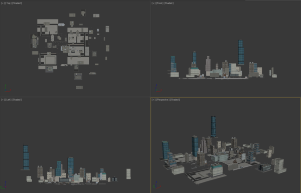

Hello,
I have this problem only with stonemason environments.
When I import a fbx of them into 3dsmax, all the parts of the environments get exploded in every direction and don't stay in place.
This is annoying since scenes from other vendors work well, and I don't want to export to obj since the materials arent always well preserved.
Perhaps there's a specific setting in the export process that I miss?
Does anyone has a solution?
Thank you

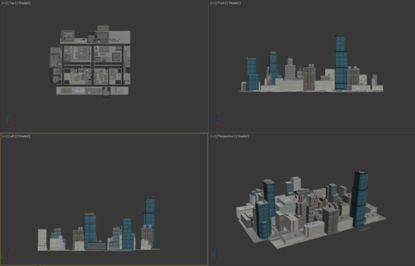

  • boumayboumay Posts: 31
    Sure,
    Here are 2 screenshot, one concerning FBX, the other as OBJ.
    The FBX is exploded, the OBJ is fine in terms of geometry placement/scale, the only reason I don't use obj is that there are other serious issues with materials and faces/weird triangulation or smoothing groups, which require a lot of work to clean.
    1546 x 992 - 582K
    1553 x 993 - 442K

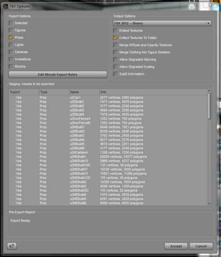

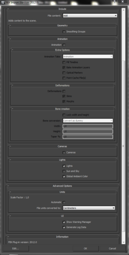

  • Richard HaseltineRichard Haseltine Posts: 111,972
    I was suggesting a screenshot of the export options dialogue, and of the 3DS import options dialogue of there is one.
    edited December 2013
    ok, here are export dialogs.
    Just to say, but I tried with degraded skinning and other options etc, nothing works.
    597 x 1173 - 85K
    733 x 852 - 141K
