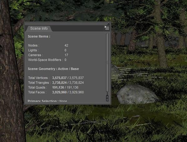

    Can you tell how many poly that forest scene has? Just curious.
    I guess that you're getting on the limit of your Graphic Card. And that may be one case where a Pro Card instead of a Gamer Card would be better
  • Richard HaseltineRichard Haseltine Posts: 111,306
    Nearly 4 million, though my 1GB video card handles it OK.

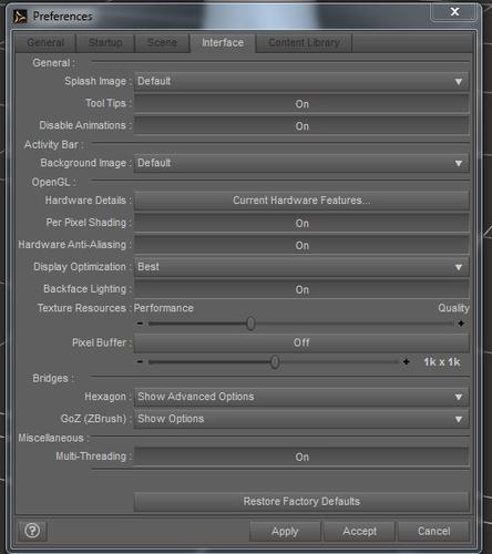

    edited December 2013
    What are you other interface settings - do you Display Optimisation set to Best? I do, and I have the Texture resources slider just on the Performance side of the half way mark so that's more demanding than your setting.
    511 x 576 - 53K
  • nDelphinDelphi Posts: 1,974
    Wow, what a difference, mine was set to None. I didn't notice much until today because I am working on a huge scene.
    Post edited by nDelphi on
  • SorelSorel Posts: 1,434
    That worked Richard! Thanks for your help everyone.
