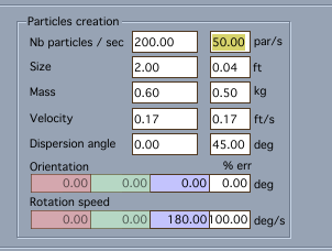

    I just tested it. The size can be keyframed over time. You can also randomize it somewhat by changing the particle size in the Particle Creation section of the Basic tab in the editor. The second field is for some variation.

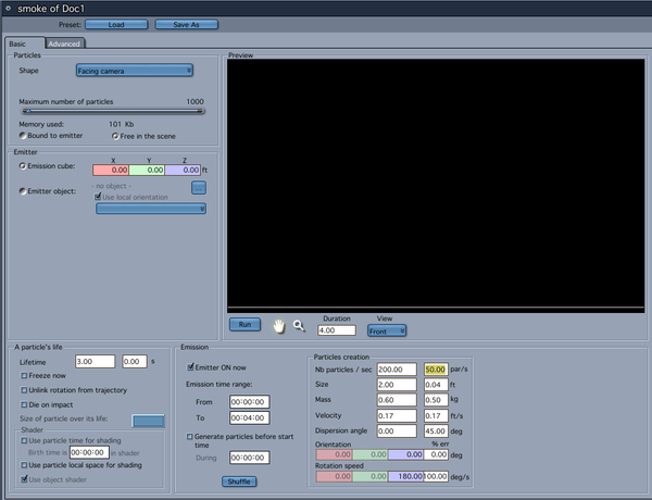

    I noticed there is orientation options as well. Have you tried any of those?
    302 x 228 - 21K
    984 x 754 - 104K

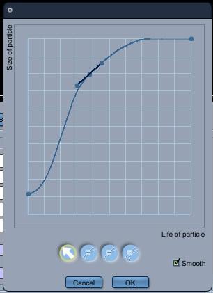

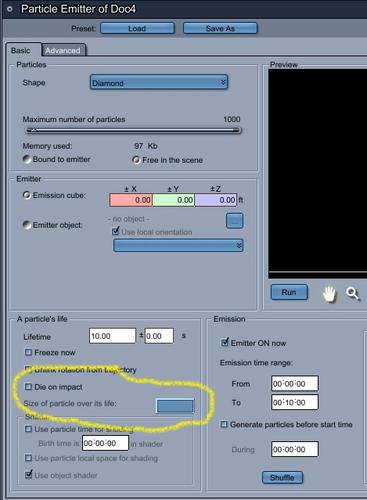

    If I understand what you are asking, set the "Size of particle over its life" which is a graphical setting. You can even have the particles grow non-linearly by adding midpoints and adjusting them up or down.
  • edited December 1969
    Where do I do this?
  • FractalDimensiaFractalDimensia Posts: 0
    Where do I do this?
    After selecting your emitter, go into the Particle Emitter modeler. You'll find the option near the bottom left. See screenshot 1.
    Click on the blue box to the right of the option to bring up the size adjuster. See screenshot 2.
    306 x 421 - 28K
    469 x 639 - 71K
