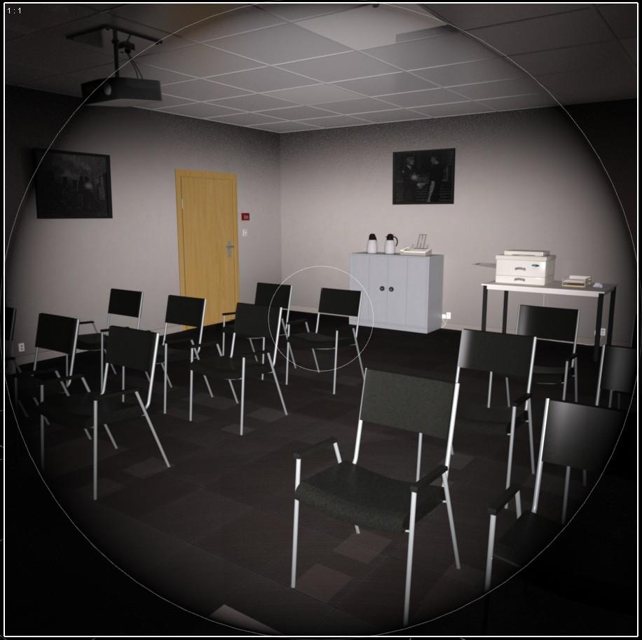

  • FishtalesFishtales Posts: 6,233
    Just to point out also. Using the Finite Box inside the building wont light it but will give some ambient light to add to any added lights.
    The first image below is the Finite Box Enlarged so you can see what it should look like and the light that is coming through the windows from it.
    The second image is the box shrunk to fit inside the room.
    The third image is the box settings.
    The fourth image is what I got using the HDRI I had already open which is the light image, the low res one not the background one, for Alexs_Apartment. I have shut off the glass so that there is no light coming through from the outside.
    981 x 479 - 264K
    506 x 434 - 92K
    965 x 563 - 177K
    1920 x 1080 - 3M

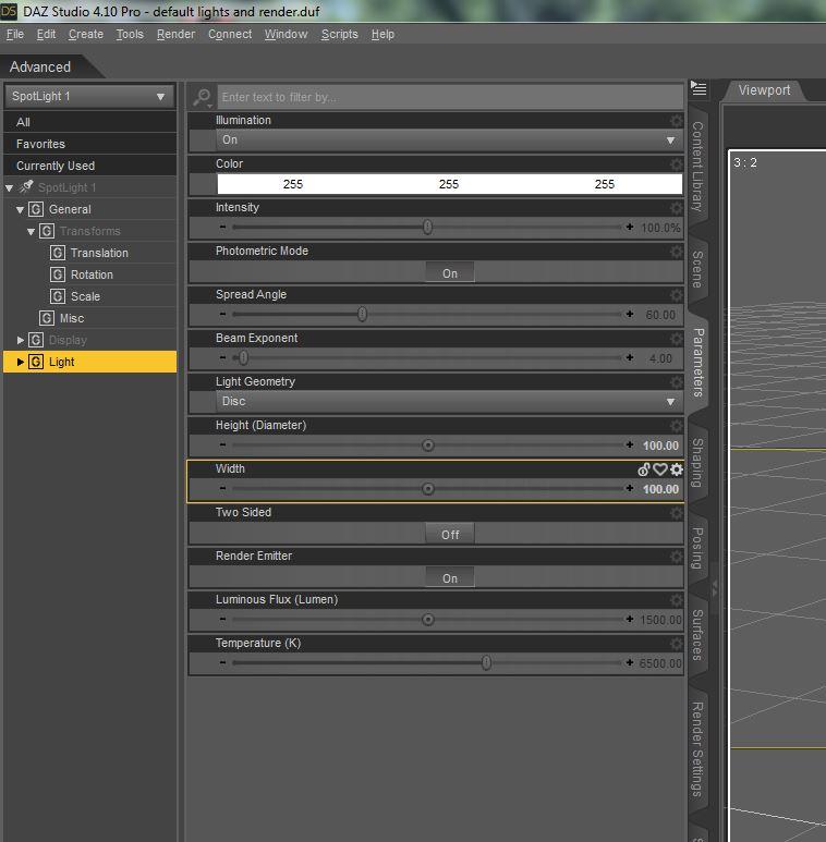

  • fastbike1fastbike1 Posts: 4,082
    edited June 2019
    @Taoz "OK, not sure what geometry settings are though"
    You can change te geometry of a spotlight in the Parameters>Light>Geometry tab. The atached shot shows a spotlight that will act like a 100cm disc softbox.
    758 x 773 - 76K
    Oh, OK, was actually playing with these settings yesterday to see what happened, but the name "geometry" just didn't ring a bell. Thanks!
    Just one (IMHO major) flaw with the light geometry settings — you can't see in the Viewport what shape and size you've just set up. Something for the next D|S version, maybe?
    edited June 2019
    You can if the viewport is set to Iray and show emmiter is on.
    Post edited by Fishtales on
    Ah, yes that's right. I hardly ever think of that, because my current system crawls through displaying the Viewport (or Aux.) in Iray, so I never use it.
