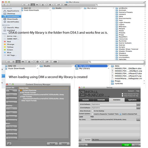

I have a folder which is named My Library which i copied from an earlier version of DS, this contains all my stuff arranged in a way that i like and which means i can find things easily. This worked with no problems in DS4.5. So when i installed DS4.6 i wanted to move that folder complete into the new app. I went through some hassles but eventually i got to the stage where i had the folder in the app, and could access everything in it.
Now i find that if i get new content i cannot install that into this folder. If i try using the DIM in simply creates a new folder with only the new content inside. If i try to manually install the new content i get an error message. I am relatively sure that the DIM is set up properly, and that the content directory management is also okay within DS4.6. That of course is not to say i am positive, because obviously something is very wrong somewhere and i rather suspect the main problem is the idiot typing this plea for help...
So i could do with some help please...
As an experiment i purchased the free Daz barn to try and find a solution.Screen shots are attached...
1024 x 1024 - 295K
Post edited by deeahr2169 on
    Hello again David.
    I really don't see what you mean about DIM creating a second My Library folder? Where is this second 'My Library' created? The path you have entered in to the DIM looks exactly the same as the one listed in the Content Directory Manager. Is DIM creating a new folder on a different disk (or area)?
    If not, then things are going into where they are supposed to go. DAZ Barn should install to My Library > Props > DAZ Farm, that is where I have it anyway.

    Its difficult to explain this because i get confused when terms such as a different disc or area are used. I have no idea what the question means. The path for content on my machine is documents/daz3d/studio/my library, and this where i loaded the folder from DS4.5. When i try to install the Barn, and bear in mind its only used as a test subject, a new folder is created in the same place as the existing folder with the same name...they exist together but i can only access the original my folder, not the one that was created when i tried to install the barn using DIM...
