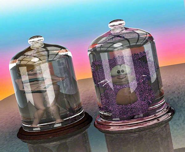

    I don't fully understand the question. You want only partly reflections?
    Nothing like this: ?

  • laverdet_943f1f7da1laverdet_943f1f7da1 Posts: 252
    no... I want fulol reflection on the side of the cylinder, and no, or less reflecting glass in the middle... !!

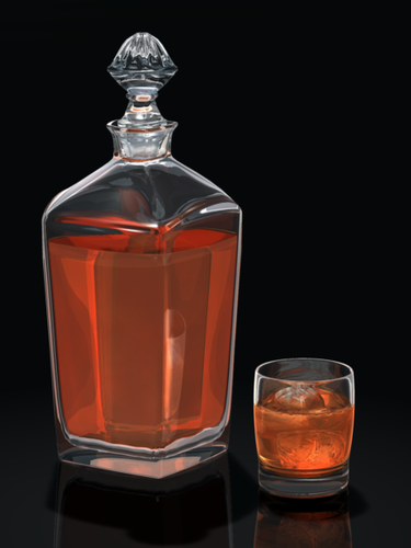

    Buy DCG's Shader Ops 1 for the Fake Fresnel shader, it makes controlling this easy with a mixer.
    or Shoestring Shaders also has a falloff shader (i think it's called Falloff), but I haven't tried it.
    thank you for your help!!! I get good results , in the reflection channel, with a color gradient , black on one side and white on the other, then fake Fresnel as child... reflection is on the sides of the cylinder, not on the center!!!
