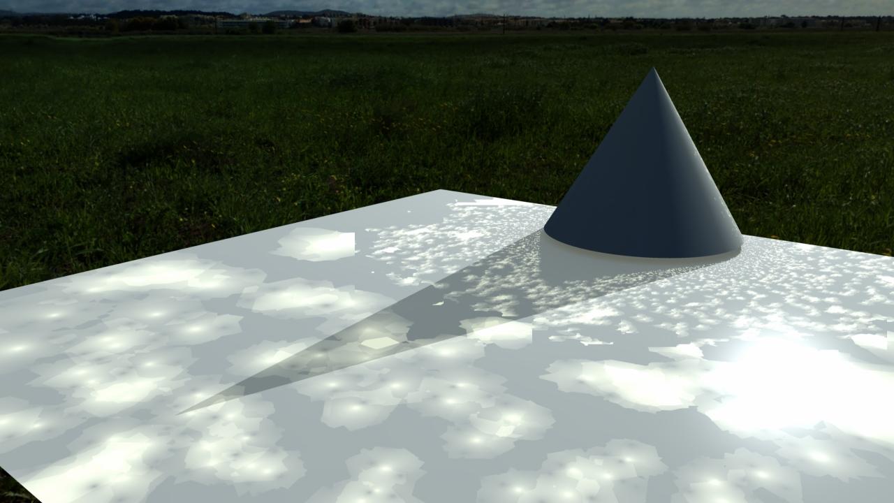

Carrara has 2 kinds of lighting, direct and indirect.
  • Direct lighting comprise all kind of lights (directional, sun, bulb, spot, anything glows, shape lights...).
  • Indirect lighting are ambient, sky light and indirect light.
The main difference between direct and indirect is that all the features of the lighting model (highlight, shadows, SSS, translucency) are used only with direct lighting. Indirect lighting considers all materials as mate, with no SSS, shadowless. If your materials follow this description, then no problem. Otherwise, renders using indirect lights often seem dull and whitish.
The goal is to add a true environment lighting in Carrara, as seen in all modern renderers.
To come back to this plugin, the idea is to create a dome of direct lights (here directional lights) with value extracted from an HDRI map. This is supposed to give the best of both world.

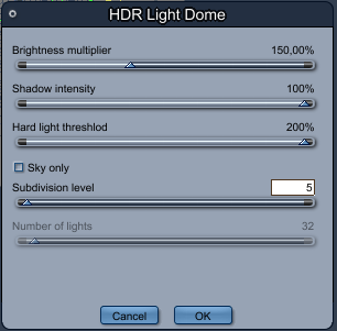

How to use it
First, there must be an HDR Background set for the scene
The command to create is in menu EDIT/Philemo/HDR Light Dome.
It open a window with 5 parameters:
  • Brightness multiplier. It's similar to the sky light intensity slider in the render room. It's related to the shadow you'll use (hard light threshold slider a bit below). The more shadow, the more brightness you need
  • Shadow intensity. Same as in lights.
  • Hard light threshold. It's the threshold below which a light will be considered a hard light (ie cast shadow). A 5% value leave only the sun as hard light in a bright sky. A 200% value has all the lights as hard light.
  • Sky only : Will generate a half dome and no light from the ground.
  • Subdivision level : drives the number of lights generated by a power of 2. 5 is 32 lights, 6 is 64, 7 is 128, 8 is 256...
Optimal is often found with 256 lights, 200% threshold. It may be a bit long to render, more if you have transmaps, so you can lower some setting. That's why the default is 50% threshold
Of course, when rendering, sky light option should be unselected.
The plugin is available at https://sourceforge.net/projects/carrara-time-savers/files/HDRLightDome_Win64.zip/download
It's Windows only (I have some issues with my Mac, I hope to solve soon).
538 x 773 - 74K
307 x 307 - 22K

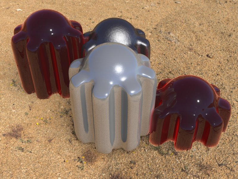

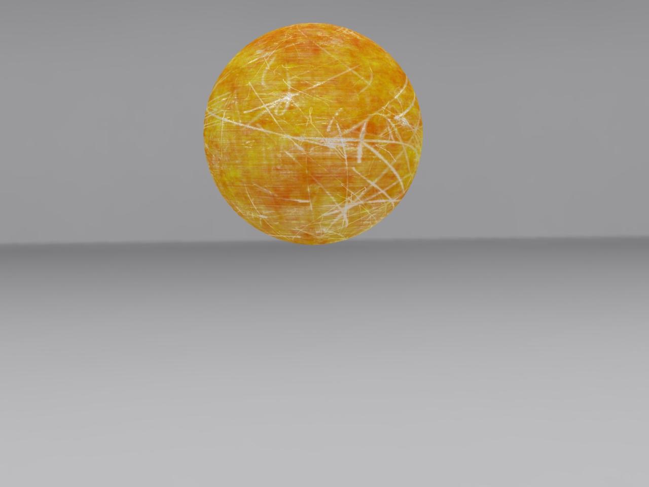

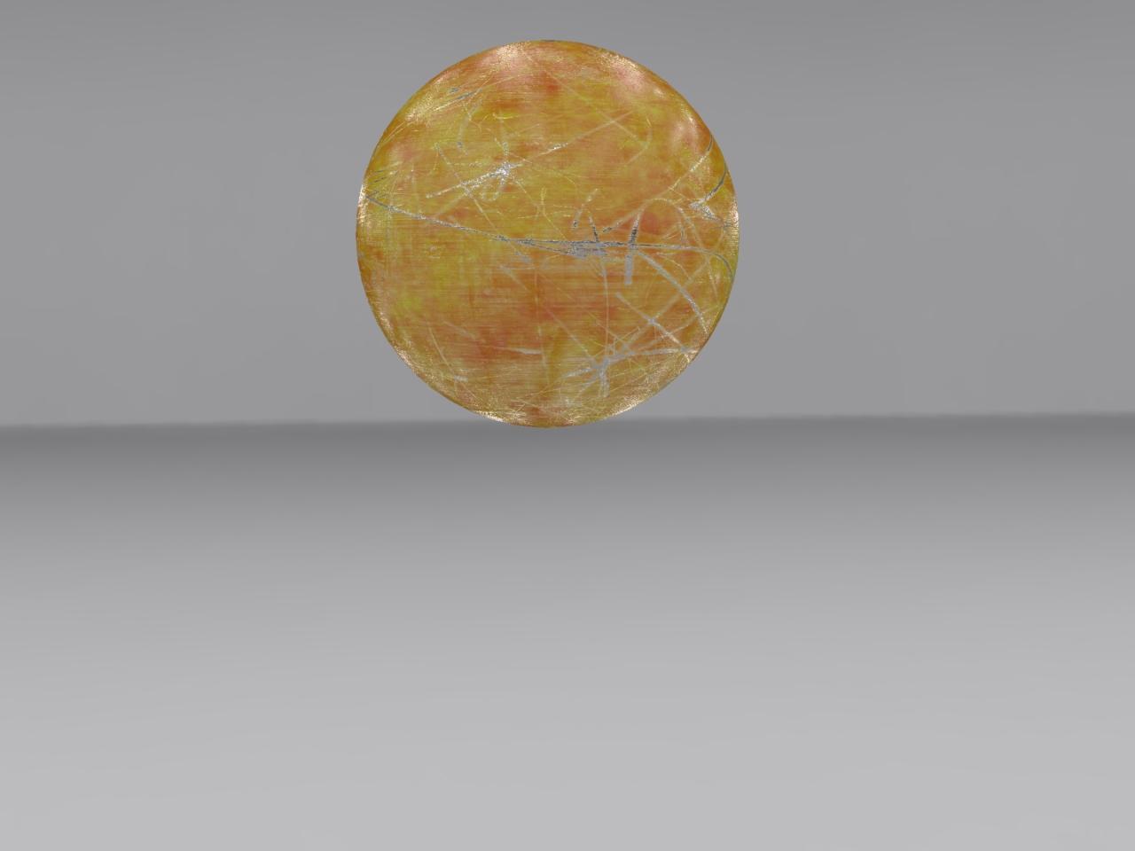

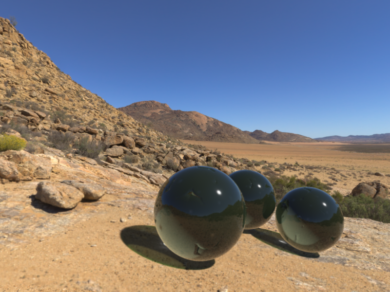

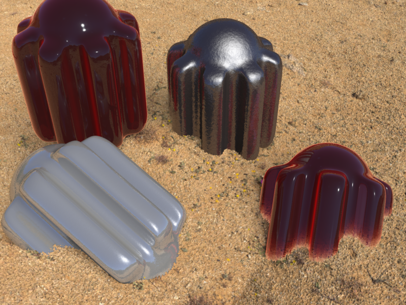

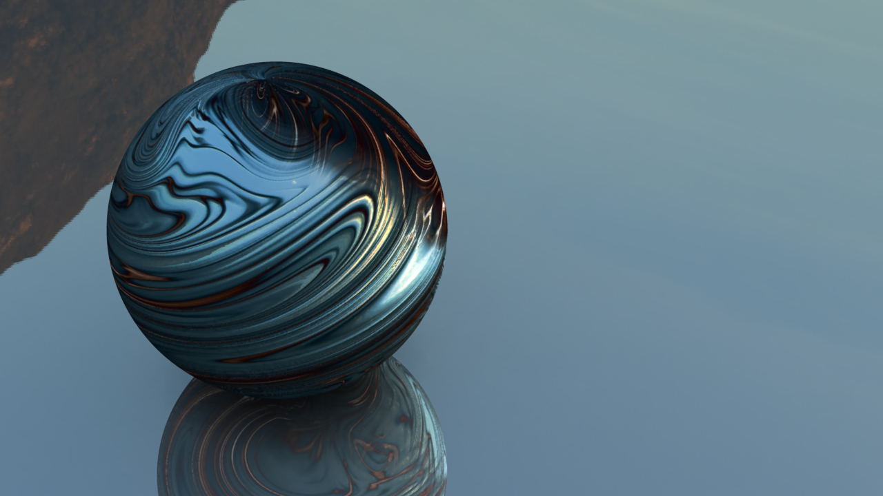

    A side by side comparison of rendering a shiny object using sky light and dome light
    Dome light
    Dome light
    Sky light
    Sky light
    1280 x 960 - 202K
    1280 x 960 - 202K
    Post edited by Philemo_Carrara on

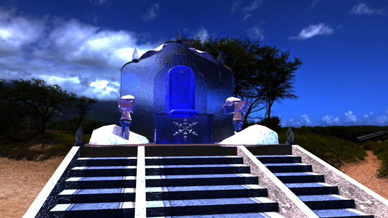

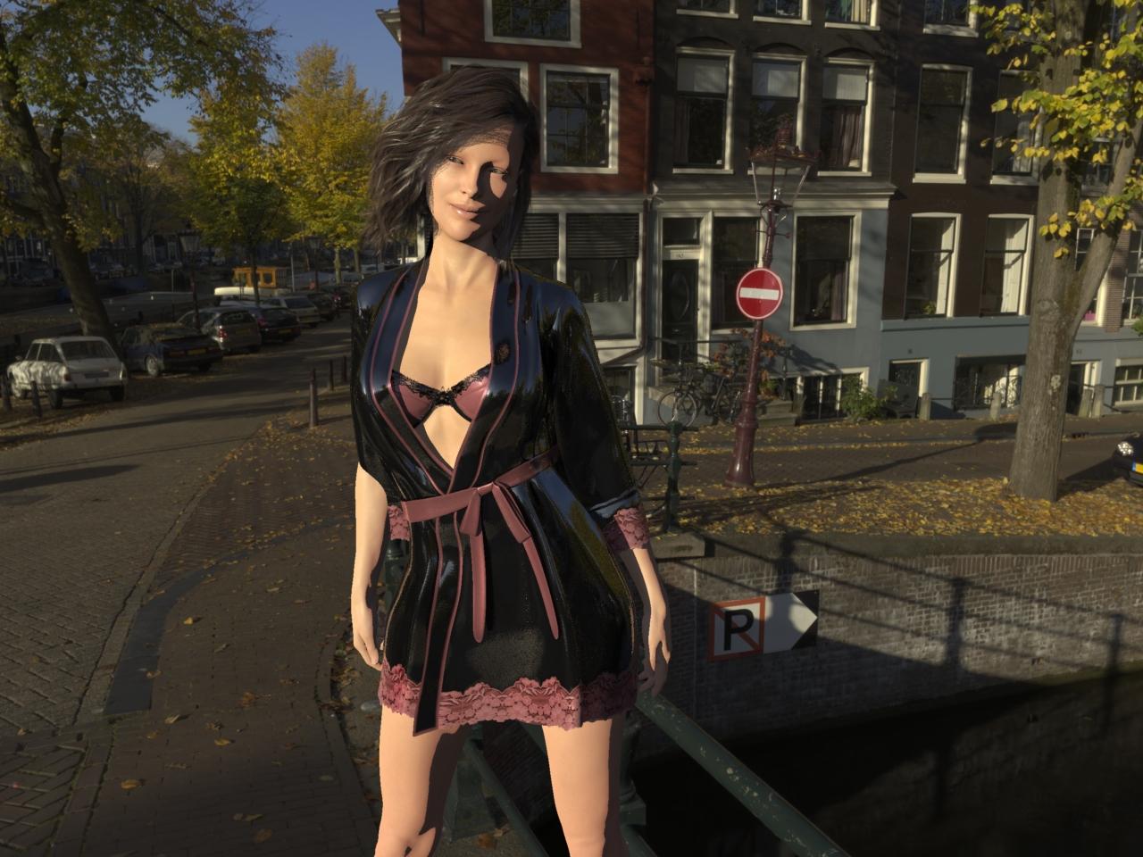

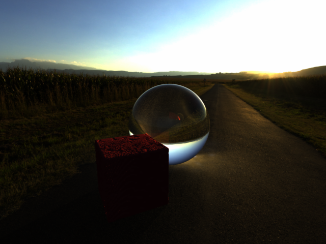

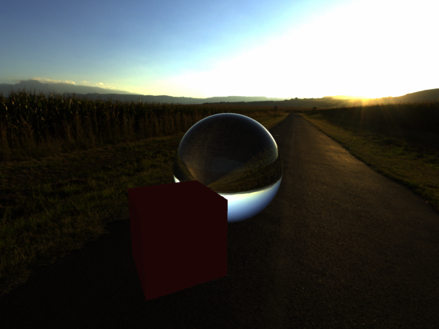

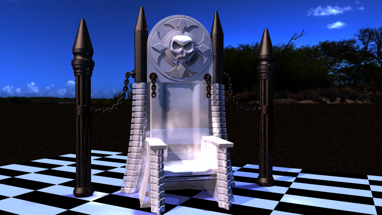

    An example of renders:
    1280 x 960 - 785K

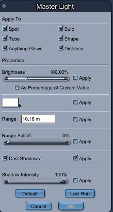

    I forgot to tell. The light dome is divided in 4 groups, 1 for the hard lights (bright dome), 3 for the background lights (top, side and bottom) and 1 main group (Light dome).
    By choosing a group, you can modify the settings via the menu commande edit/Master light, which will allow you to fine tune ight intensity and shadow without deleting and recreating the dome.

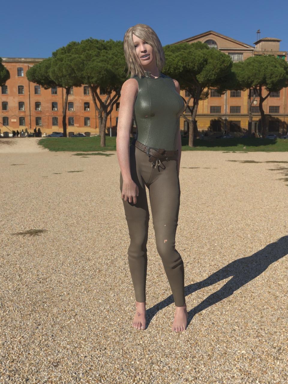

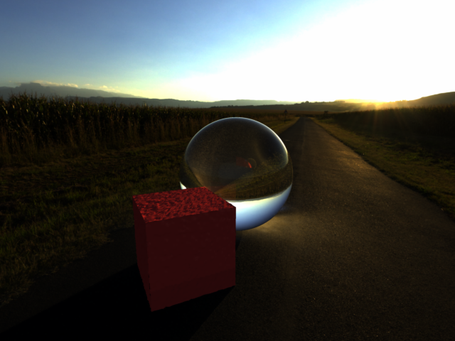

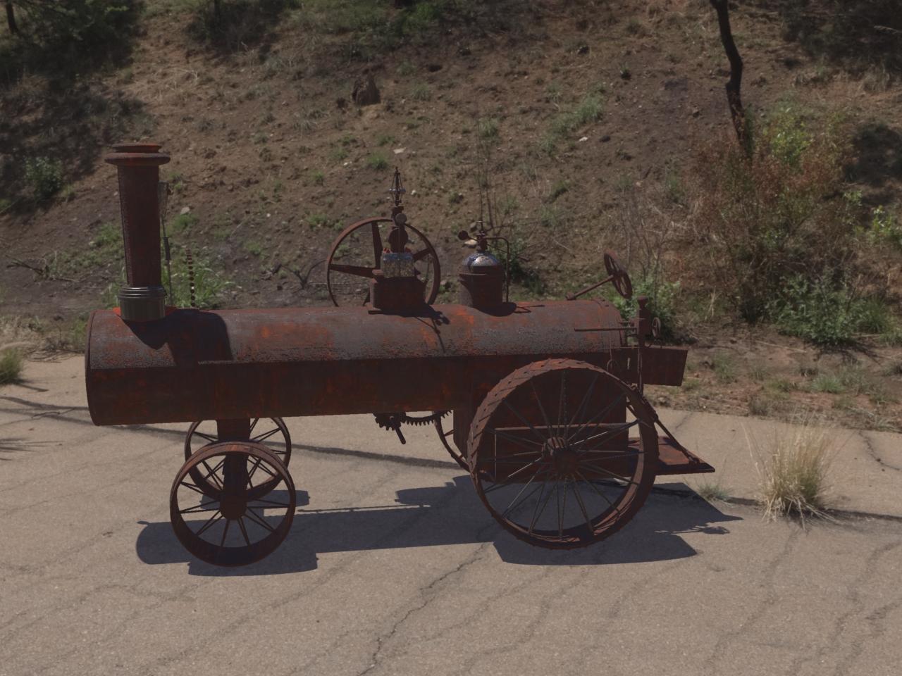

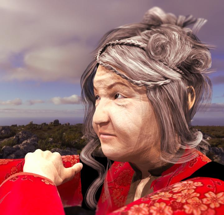

    Another render
    Old Tractor
    1280 x 960 - 812K

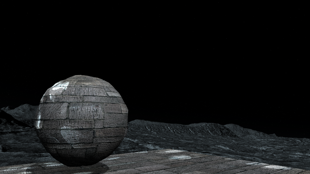

  • Philemo_CarraraPhilemo_Carrara Posts: 1,175
    edited June 2019

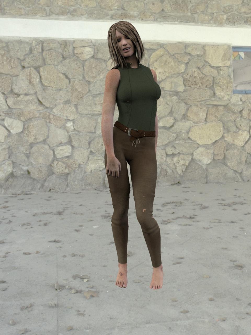

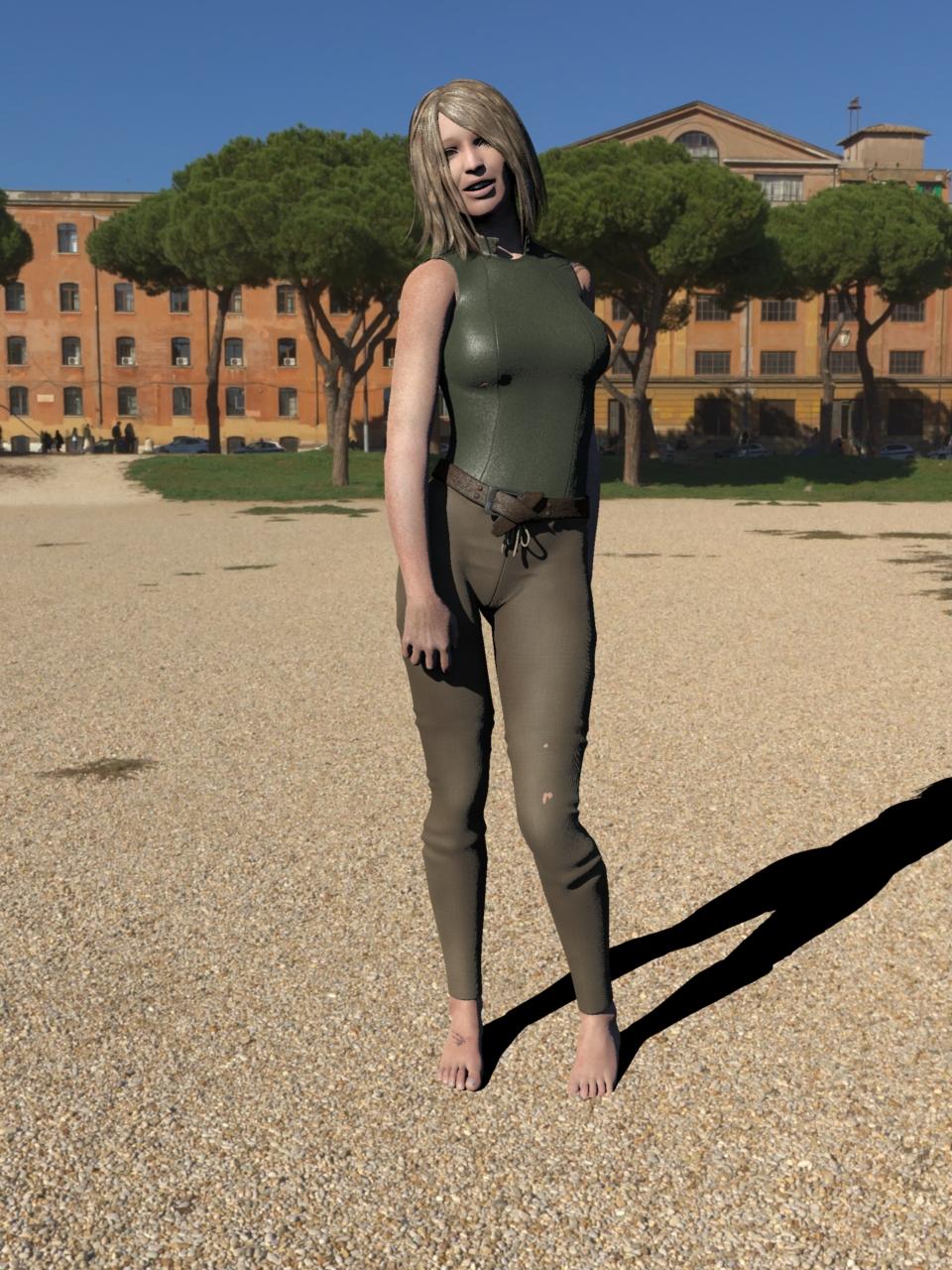

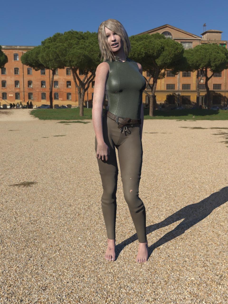

    Very nice Selinita
    Yes, Ambient light has to be turned off.
    I didn't think of applying lens flare, but it's a very good idea.

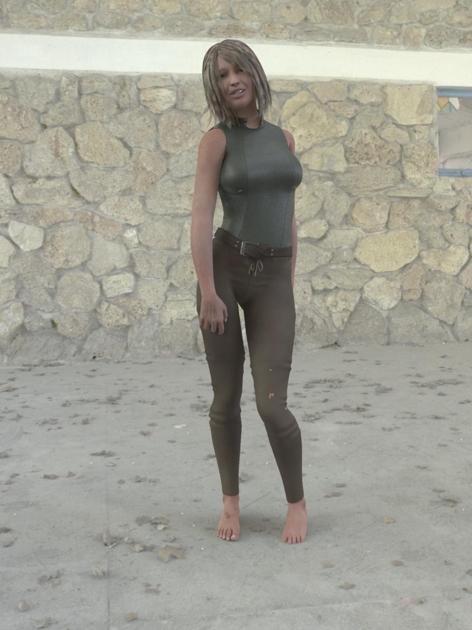

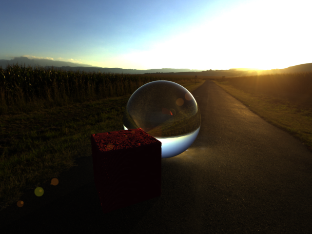

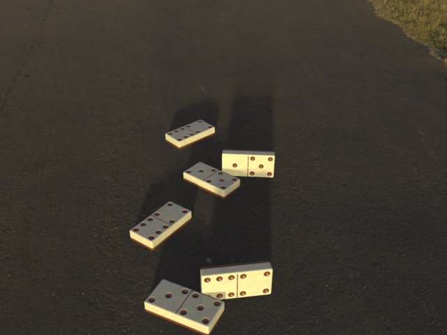

    Selinita said:
    A series of images testing the effectiveness of Phil's HDRI-Dome plugin...
    image image image
    1. No lights in scene
    2. Dome create settings of: Brightness 200, Shadow 100, Threshold 35, Sky 0, Subdivision 5
    3. Dome create settings of: Brightness 200, Shadow 96, Threshold 200, Sky 0, Subdivision 9 - Ambient light turned off and shadows of Bright Dome lights group set to 40% to better match HDRI image
    Feel free to add a lens flare for effect...

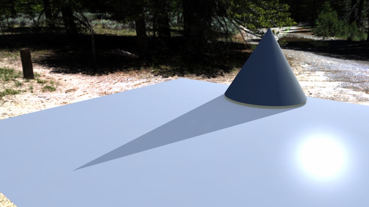

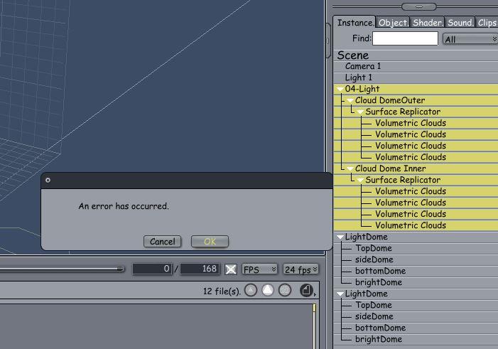

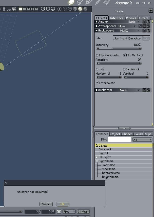

    @Philemo_carrara thanks for the plugin.. been playing around with it with success but I also can replicate a bug where it throws an error when loading.
    Happens with PhilW's clouds
    if I load his clouds then load up the lightdome it will crash ( throw out an error )
    if I load the light dome first then the clouds it seems ok with that.
    701 x 491 - 58K
    Post edited by Stezza on
    @Stezza_Carrara9 ,
    Glad you can find some use for this plugin.
    I don't have PhilW product, but I may have an idea. Could you tell me what is in both environment and background slots for the scene when it crashes?
