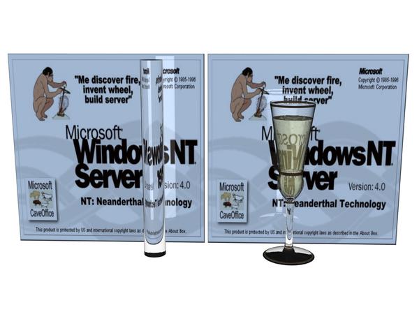

  • SlimerJSpudSlimerJSpud Posts: 1,456
    You can do refraction, but splitting white light into a rainbow? I don't think so. If you take a solid shape and set the opacity near 0, and the refractive index >1, you do get refraction effects. I bet Luxrender will do rainbows.
