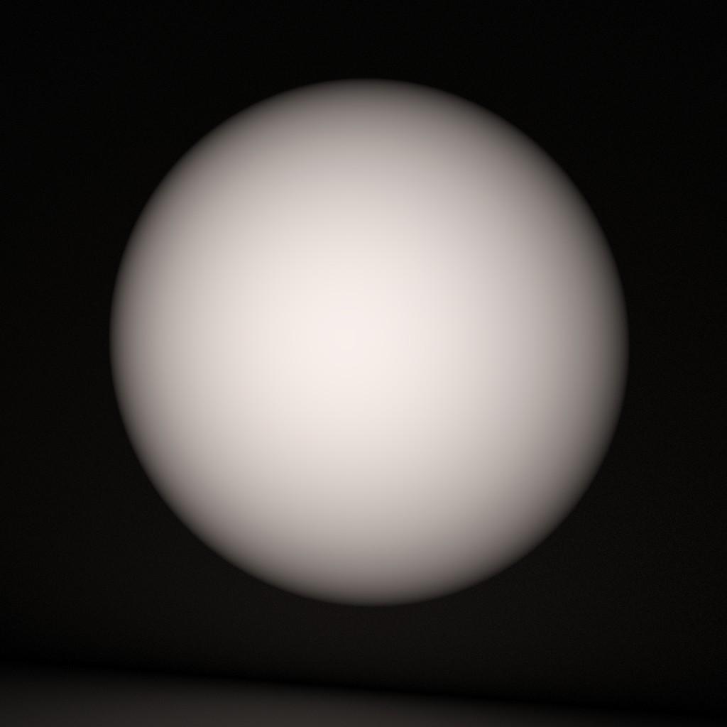

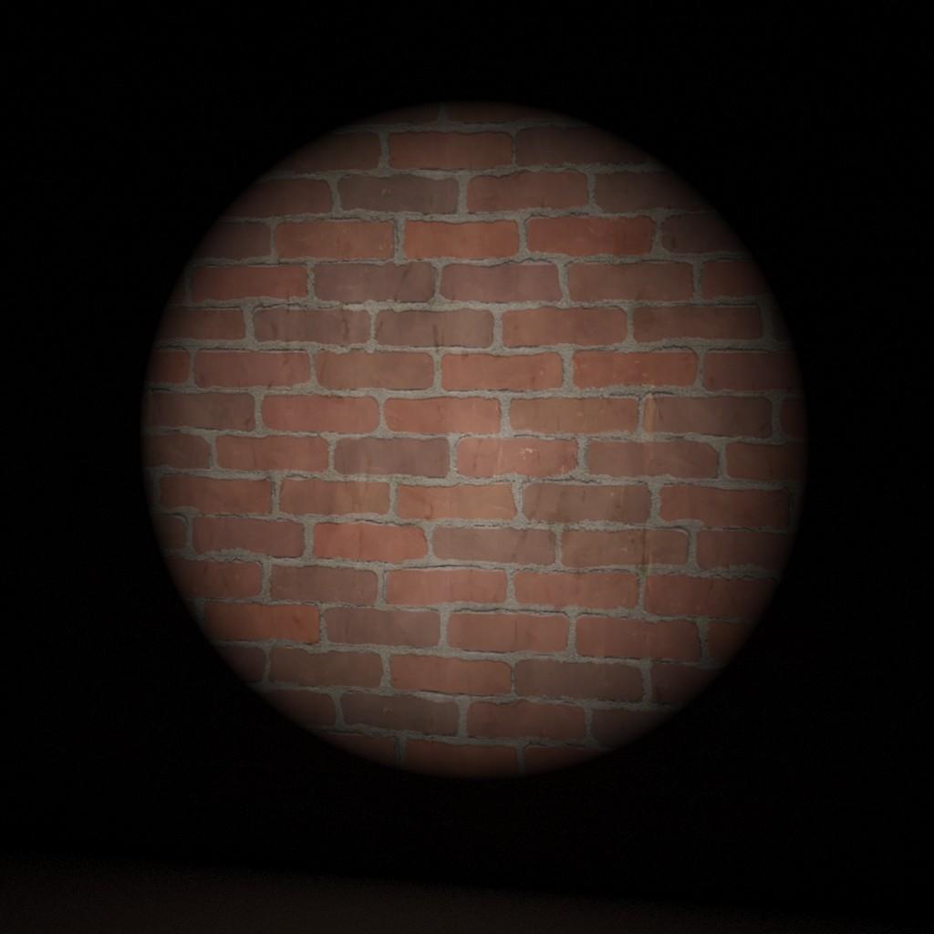

    You can do it in IRay, but you need to set to Scene Only, as Mazh suggests, and also ensure the camera head lamp is set to off. For the spot light, set a smaller Spread Angle (I used 25), bump up the Lumens to some big number, and change the Beam Exponent to 1. The circle is unlikely to be as sharp as in 3d delight, but will more realistically show the behaviour of a bright spot light. Below is what I got shining the light on a white painted wall, and a brick wall.
    1024 x 1024 - 100K
    1024 x 1024 - 73K
