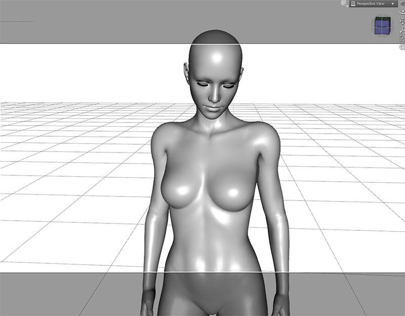

I'm looking for suggestions on how I can smooth just the shoulders on a character.
As you can see (and most of us are used to), the shoulders have this weird angular blocky-ness to them.
I know switching to a higher subdivision level solves it, but like to use the lower resolution base model if possible.
I've tried using the zone smoother product, but it really doesn't work right in this case. Adding enough iterations to smooth the shoulders means they also go weird and low down.
Can ayone offer any other suggestions on how this could be done?

     First, I would render and see how it looks since the OpenGL preview is not what you should judge by. Second, render her against the background you intend to use to get a better idea of how your final use of the model will actually look.

    Thank you for your response, but I should probably clarify a bit. :)
    I'm aware that when rendering the bocky-ness with disappear, but this is actually so I can export the model (with smoother shoulders).

    You can't smooth more than what the geometry allows. So in order to smooth more you must add more geometry. And that can be done with subD level; but that will affect the whole character - not "just the shoulders".
    If you intend to use it for export, I would suggest adding the extra geometry (and smoothing) in a modelling program.

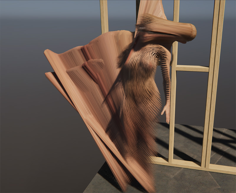

    EDIT : I feel I should also request that if anyone knows how to export the higher res subdivision levels to unity correctly to unity3d, I'd also rally appreciate that. I know how to export the higher res version as an fbx file and get it into unity, but the skin has errors as soon as I apply the animation.

    Thanks. Yeah, the fbx export with hi res doesn seem to be the source of the issue. Still going to try and finds a workaround though.
    I can export the hi res Genesis 3 in obj format, them use mixamo to generate a new rig. It works well in unity3d. The only problem is that I lose all morphs.
