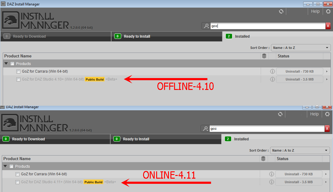

WOW.... I don't believe this. I went offline and looked at my DIM as you said. In files READY TO INSTALL was the 4.10 version ready to install. So I installed it. And it showed up under INSTALLED, but grayed out. I guess when I clicked whichever version when online it just 'hid' in the ready to install area?
Then I looked in my DS 4.10 plugins after opening the programme and there it was again. With the numbers that I first posted that you said were 4.10. Also the GoZ option was under File dropdown menu. I exported a figure, changed something, but it would not come back into DS 4.10. So I am sort of back where I was, EXCEPT....
I went back into DIM this time online and there in the INSTALLED section was the 4.11 versionas I had said, and grayed out. Yikes.... what is happening.
See attached screen shot. (At least I do not feel so insane now, just confused!) What does it mean. Will GoZ ever work properly in DS Public Build again? I will go away now and let you have a think on this and see if there is a solution. Thanks for all your kind help, Richard, it is much appreciated. You have saved me often in the past.
When you are OnLine, if the version you have downloaded is older than that on the servers, DIM won't know it is "out of date". When you are off-line it doesn't have access to the updated version and will use the one you have downloaded instead. It sounds as if you do have the 4.10.0.123 version of GoZ, and it does sound as if it is working as a plug-in. That just leaves the issue of communicating with ZBrush - have you tried resetting the path for DS in the ZBrush peferences?
That was it... it was not connected. How did that happen? It worked the time before and I have not changed any directories or anything. I didn't look at Preferences, was checking the shared apps files instead. I think ZBrush must only ask you at first setup, then if it falls off, it's not going to warn you there is no programme connected. Kind of cheeky for such an expensive programme not to set up a flag if there is no path back to the importing programme. It just did nothing.
Sorry, I was barking up the wrong tree... so I can hope that the version of DS I have will continue? Or will 4.10 pro public build beta be 'dissolved' when 4.11 comes out? I think I understood that if I want to have two versions one has to be the public beta thingy.
Thank you for your help... are there any other demons I need to know about ???
The version you have installed will not be updated automatically, and as long as you make a copy of the zips outside the downloads folder you can always reinstall if you grab an update by mistake.

ETA: When I look at the current package in my Product Library for Daz Studio Pro BETA it does not give any version number. So if they are getting ready for 4.11 pro public build beta stuff... could they have removed the 4.10 version of GoZ as it would be part of the package, so maybe it grayed out and was substituted with the proposed one? If that is so, will the entire 4.10 pro public build disappear as well? That could explain it...maybe?
This is the package with included items on my page. There are no version numbers.
What's Included
I went back into DIM this time online and there in the INSTALLED section was the 4.11 version as I had said, and grayed out. Yikes.... what is happening.
