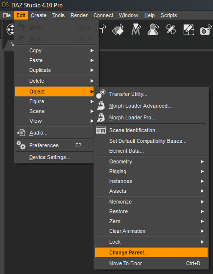

    • If you right-click on a prop Object in the Scene tab, and select the Change "Object" Parent… a dialog window opens showing all the nodes available for parenting to.
    • Below that are two options, Parent in place and Show Hidden Nodes.

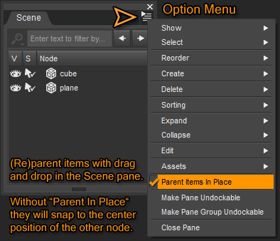

    The short answer to the OP question: Go to the Scene pane option menu and check Parent Items In Place.
    If you want to know why read: Drag & Drop in Scene pane, "Parent Items In Place" global setting

    One way to (re)parent "things" is to use the right-click menu in the Scene pane, or the main menu Edit>Figure/Object>Change Parent.
    The downside of the Change Parent dialog is you can only parent a single thing ;) (item / figure) at a time. The checkmark "Parent in Place" at the bottom applies only to the current action.
    The other method of (re)parenting is simply using drag & drop in the Scen pane, which I prefer because you can parent multible selected items / figures at once. In this case there is a "global" Parent Items In Place setting in the Scene pane option menu, that is a toggle switch and once set it stays like this between DS sessions. Notice even it says "Items" it also applies to figures.
    You may never have used drag and drop in the scene pane but this Parent Items In Place setting will also affect what will happen if you right-click an item / figure and choose Unparent. I think this Parent Items In Place checkmark is a bit hidden so I've added it to a toolbar. It dosn't have an icon but the text gets a highlighted color if activated to remind me of if its currently on or off.

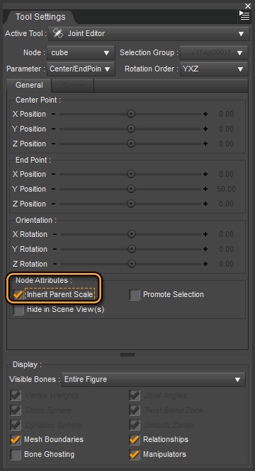

    If you want to change the Center Point of an item / object / figure select the Joint Editor tool, open the Tool Settings pane and move the green crosshair to change the Pivot / Origin Point how the Center Point is also called.

    In case the item / object you parent your selection to has scaling applied by default the parented items / figures use the setting Inherit Parent Scale, so they change scale in relation to the scale of the item / figure they are parented to. Most times this is not what you want. You can change that by activating the Joint Editor tool and open up the Tool Settings pane to uncheck this Inherit Parent Scale setting.
    Edit: Otherwise if you scale a Group you would expect the parented elements in that Group to change scale acordingly and this is what happens by default.
