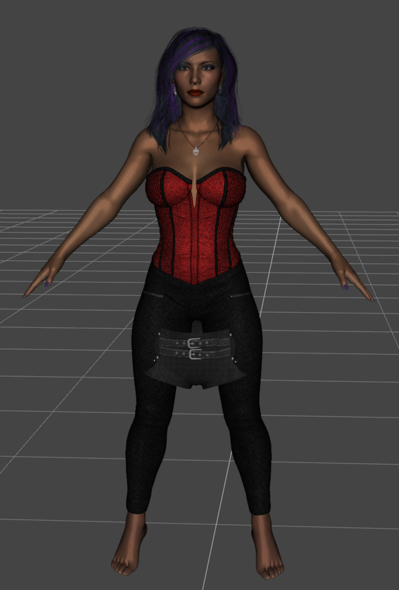

I'm having a strange issue with the RiverSoft Art Genesis 3 to 8 clothing converter (https://www.daz3d.com/clothing-converter-from-genesis-3-female-to-genesis-8-female) as well as with autofit from G3 to G8, or even self-converted clothing using SY's method. Some converted (or autofitted) clothing does not align with a character if I use the Genesis 8 Female Body Morphs (https://www.daz3d.com/genesis-8-female-body-morphs) to change the figure's height. The clothing will shift and end up higher (if I make the character taller) or lower (for shorter characters) when I make the adjustments.
It is weird that some outfits, like the Vigilante Outfit (https://www.daz3d.com/vigilante-outfit-for-genesis-3-female-s), work fine, while others such as the La Peligrosa outfit (https://www.daz3d.com/la-peligrosa-outfit-and-accessories-for-genesis-3-female-s) do not.
If I adjust the character scale or use MeasureMetrics, I do not have this problem. While the solution of using FigureMetrics could work, all of my custom characters currently use the Female Body Morphs and it would take a lot of work to re-create them with figure metrics.
Here is an example. Both the Vigilante Outfit and La Peligrosa outfits were converted using the clothing converter.
800 x 1181 - 415K

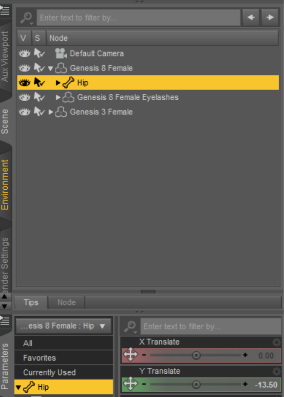

    I think I found the cause for the misalignment. Unfortunately, it doesn't lead me to a DIY fix.
    When you use the G8 feemale body morphs height slider, it changes the Y transform for the hip of the character. The image below is from a G8 base set at 100%, so she was shorter. Note that the hip Y transform is now -13.50%. When I set it back to a 0% morph, the hip is back at 0.00%. This hip adjustment does not happen with G3 using the same slider from the G3 version of the morph pack.
    If I set the hip to zero, the character floats. Unfortunately, the clothing stays the same. So it looks like some clothing adjusts relative to the hip setting on the character. Likely DAZ is adjusting for the positioning of the hip, which pushes it down (or up) on characters using this slider.

    Chezjuan said:
    When you use the G8 feemale body morphs height slider, it changes the Y transform for the hip of the character ... This hip adjustment does not happen with G3 using the same slider from the G3 version of the morph pack.
    Thank you very much for sharing what you found. This is interesting. Also please let us know what the customer support replies.
