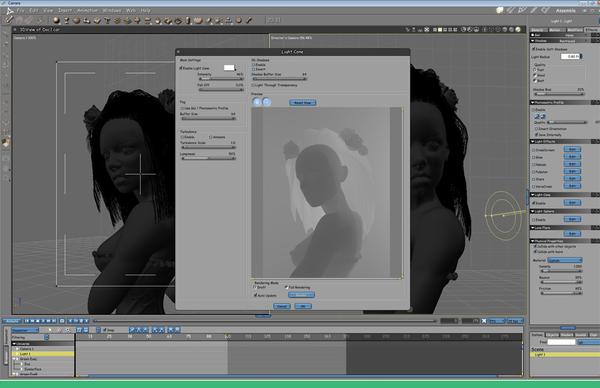

I have had a go at these in the past.....it is all a bit hazy these days. I gave up on them because it was all a bit complicated. Two stumbling blocks I seem to remember were a jaggedy edge and hair would not render.( this is using the multi-pass rendering.)
I think I just had one of those cartoon lightbulbs appear over my head.
See what you think....
I am experimenting with a light cone for my "Sugar Skull" girl,and I just wanted the rays and nothing else so I could try and composite it in photoshop. So I made all the textures black and did a render. Now, this render looks suspiciously like a depth map to me...mmmm may be I could use it as one? It has no jaggedy edges and the hair is there! What could possibly go wrong.....
I will have a play tomorrow when I am awake. Just thought I would share it,feel free to tell me it wont work...or even have a go and tell me how to do the rest! ( I know its a bunch of shennanigans in photoshop layers....and they do my head in!)

    There is a render pass that will display hair as a silhouette, but off the top of my head I don't recall which one. Since I'm gong to use the function shortly, I'll experiment with it in the next couple days to let you know which one.

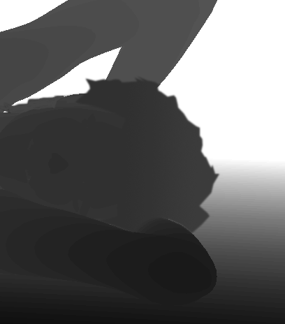

    What I do, since the silhouette is sold black, is to extract it by drawing a poly line around it in PS and copy it. I then paste it into the depth pass and adjust the brightness value to roughly correspond to the head's values.
    Your method looks like it should work great as well. The only issue I can see is if you were to have a background it may not work quite correctly. The way your scene is set up at the moment makes your method perfectly viable.
    As to the light cone, if you want a blacked out figure, the multi-pass option may work better as it's a solid silhouette, but as I said, I have to experiment a bit to figure out which one it is.

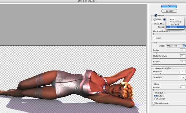

    If you use a relatively modern version Photohop, go to Filters--> Blur--> Lens Blur. It will open a new, large window with the lens blur parameters. There's a pulldown menu that gives you the option of selecting a layer with depth information. It's pretty simple. If it's an old version of PS, such as PS 7, then you won't have that option.

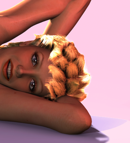

    In the example I posted, you'll notice the hair in the depth pass is a uniform grey. I traced around the hair with the poly line tool in the colored layer, feathered the selection one pixel, then switched from Layers to Channels and found my depth pass. I then painted in the poly line with a shade of grey similar to the head. Took less than five minutes.

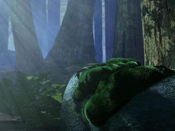

    It's far from perfect, but what I've done for the light cone and hair, is render the figure without the cone, then enable the alpha in the render room, enable the cone and hide the figure. I sometimes will put a light gel on the light and enable the shadows option and the light gel option in the light cone editor. See the moss example pictures.
    The other option that I like is to use a volumetric cloud with low opacity to generate a "real" light cone. The image with the airship uses this trick.
