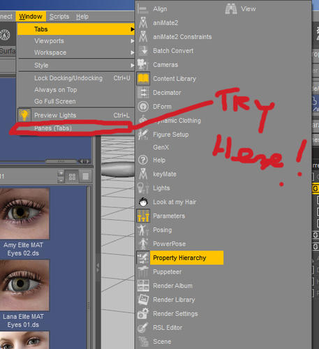

    Property Hierarchy is in my list (see below)
    Have you tried Panes (Tabs) at the bottom?
    548 x 600 - 171K

    At the bottom of the drop down menu is what I meant :)
    See the image below. I don't know why I have the pane, and you don't, it is the same version I am using. If this doesn't work, we can investigate further.
    548 x 600 - 197K
