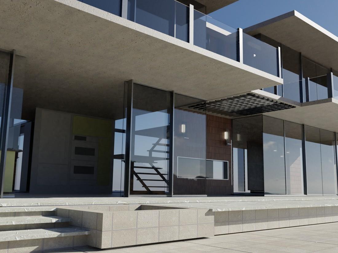

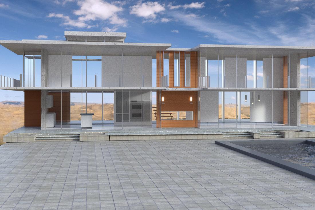

    You are welcome. Your 3D model is really great and you should keep work on this one. To motivate you more I did some adjustments to the materials and did some other renders also some closeups.
    I will give you the blend file soon, I need to look for the copyright of 2 image first and you can also share the blend file. I also want to explain how to setup the scene for Cycles rendering.

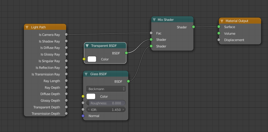

    I did 2 renders more, one that shows the inside. To get more light inside the building I did changed the glass material. I added a transparent node with a mix shader node that is controlled from a Light path node. The "Is Camera Ray" switched between the glass shader and the transparent shader. If the camera sees glass the glass shader is used otherwise the transparent shader is used.

    is the Is Camera Ray part of Iray or Cycles?
    Post edited by StratDragon on
  • PetegePetege Posts: 29
    edited May 2019
    No, the normals are ok, but the dark part (strip)  has an angle of 45 degrees.
    The Is Camera Ray is part of Cycles.
