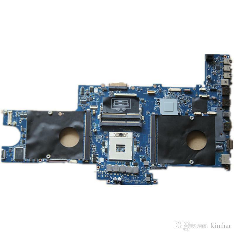

What's the laptop model? Most GPU's are soldered directly to the mainboard in laptops.
It's an Alienware M18xR2.
The Alienware M18xR2 Motherboard includes 2x MXM video card expansion ports.
You can see in the included picture, the video cards go where the black protectors sheets are mounted on the motherboard (MXM slots are on either side of the CPU socket.)
So... Technicaly you could install 2x GTX 980M 8GB cards in the machine. (as long as you have the heatsink and fan for it and the 330w AC adapter)
Good to have the picture with an idea of where the two cards should go.
