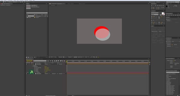

    Here is a pic you have to animate the opacity of upper layer
    2000 x 1069 - 413K

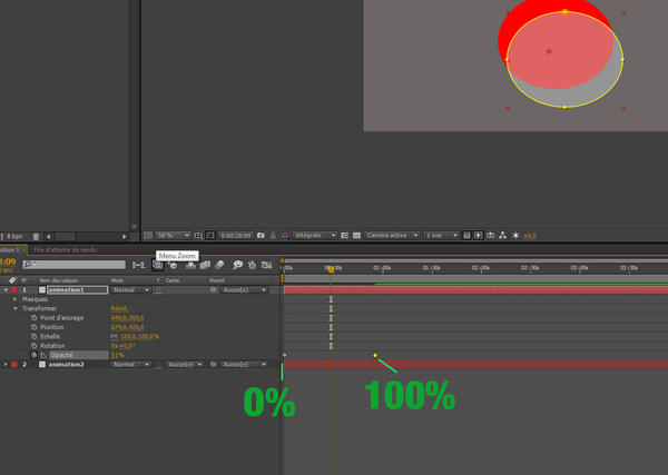

    And the values: from 0% to 100%
    1218 x 867 - 206K

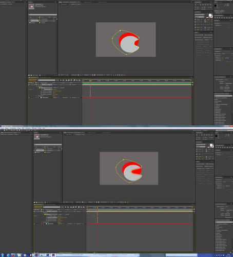

    If you want to make something more complex, you can create a mask .You can animate the points of this mask, so the layer will appear parts by parts (more control)
    1308 x 1440 - 448K
