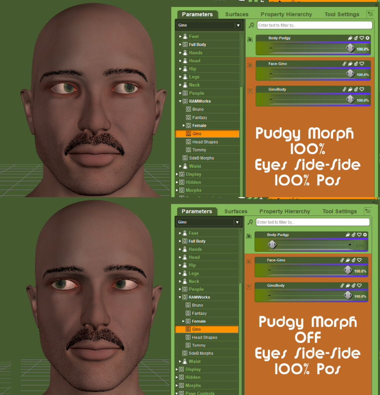

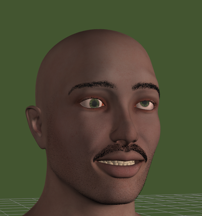

Here's the process.  I load up a fresh copy of G8M, Apply my Gino set to him, Face morph (made in ZBrush) and Body morph (comprised of in house DAZ morphs for better compatibility with clothing).  I then dial in the Gino-Pudgy morph and the eyes go all wonky about half dial.  When it's fully dialed in the eyes go unwonky but what if end users want to use just a bit of the pudgy morph?  I've done all the research I can.  I've even completely recreated the morph from scratch (like it better actually) and Adjust Rigging to Shape and then ERC Freeze it and saved it out.  STILL getting this issue and not sure what to do at this point so I'm reaching out
Don't laugh, screen gab below... OK, it's funny but it's not funny!  cheeky

    Oh and the eye morphs I'm using to test this are the Eyes Up-Down and the Eyes Side-Side.
    For the Eyes Up-Down -100 makes the eyes crossed and 100 the eyes each turn to the far outer sides
    For the Eyes Side-Side Right eyeball goes UP and the Left goes DOWN.  In the negative the opposite happens.  It's like the rotations are messed up but only for these middle dial settings!
    I've tried dialing out the Gino Head morph and the Gino Full body morph and then Both, the issue remains.  angry

    One other note.... when I dial the Pudgy morph up and use the Eyes Side-Side they go to the Left, when I dial the morph completly out the eyes pop to the Right side.
