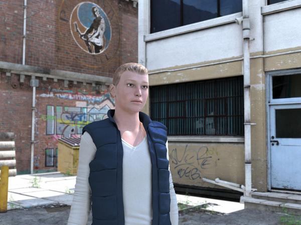

Hello to all,
does anyone know why some decal don't get transparent in AO mode? I've checked both the light through transparency filters but the outcome is as in the following images; some are good others don't. It's a known bug or what?

    Am I correct in assuming the issue you're having is the circular emblem on the wall in the first image, and the graffiti in the second image is what looks correct?
    What are you using for the alpha channel? An image map? Have you compared the settings in the shaders that work versus the shaders that don't to see if there are differences in how they're set up?

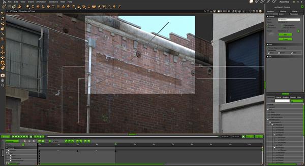

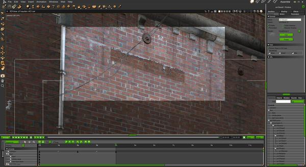

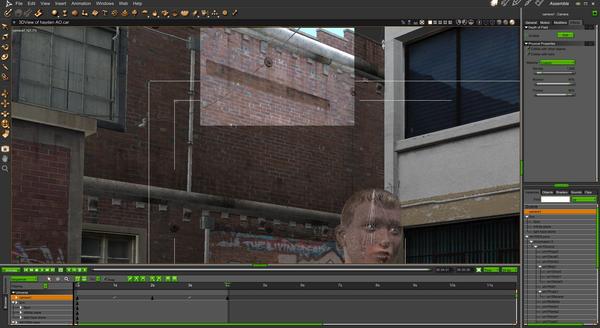

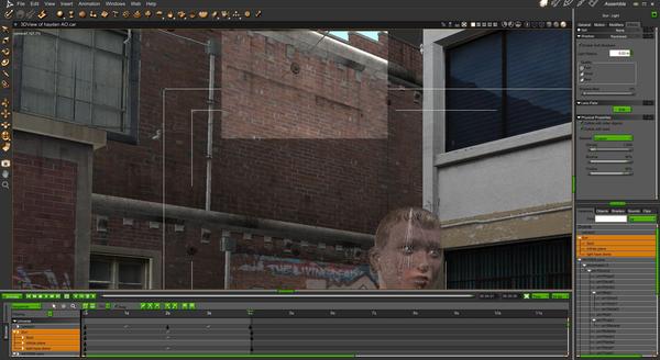

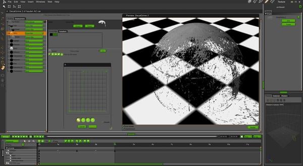

    yes EP I have tried almost everything in my ability; meanwhile, I have identified the guilty, it's an annoying bug related to the GI sky light function: below you can see 2 screenshot, with no sky light checked , with sky light intensity set to 30%. As Holly has pointed out it must be a sort of shadow casted on the wall. So I have used a curve filter in the alpha channel to enhance the contrast between opaque and transparent and here is the amazing result
    EDIT: the right sequence from top is: 1-3-4-5-2
    1920 x 1050 - 318K
    1920 x 1050 - 317K
    1920 x 1050 - 272K
    1920 x 1050 - 318K
    1920 x 1050 - 327K
