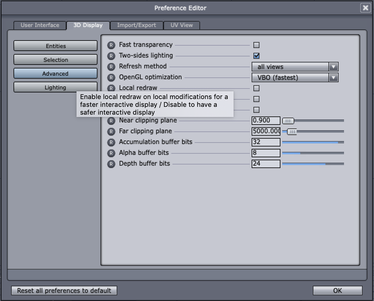

    I will also say that I've been exclusively using the beta for the past several months and have seen significantly fewer times that Hexagon crashes. Especially after disabling the "Local Draw" option in Preferences.
  • CowrieCowrie Posts: 136
    Switching to beta made it last a bit longer before the error happened.  Maybe disabling "Local Draw" would help even more.  Out of curiosity, what does that setting do?
  • If I remember rightly, the Local Redraw updates all the open views at once, so if you have top, left, right & front views open and you move something then all the views will change at the same time.
  • de3ande3an Posts: 915
    You're thinking of "Refresh method".
    "Local redraw" is supposed to somehow make the display respond more quickly. The default setting has always been set to "ON".
    The feature is now broken in the latest updates.

    However, I did try disabling the local draw setting, and that seems to have fixed the problem.
