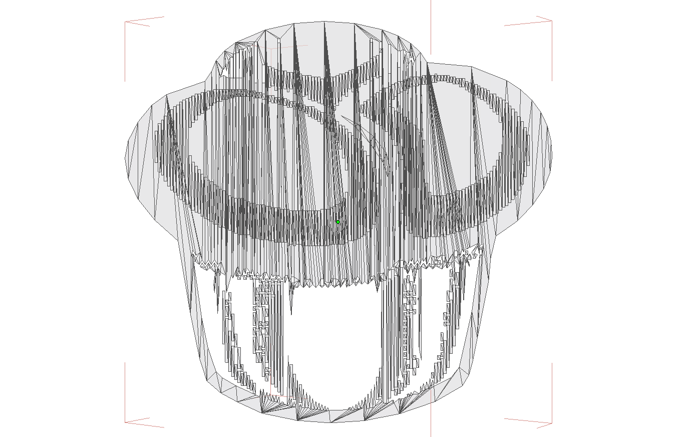

    Okay, so a few things...
    First (and most important) the 3D mesh is an absolute mess! Could you clean it up? Maybe. With hours and hours of work. But it would probably be faster to just start with clipart of a cupcake and make your own model.
    I was able to get it to load by pulling it into my UV mapping tool and removing all of the groups (there were 800 mesh groups on an object that only has 1700 polygons). There was also another figure (Lisanne?) embedded in the OBJ file which had a whole different set of issues with it. I removed that completely to get it down to just the cupcake.
    But, like I said, I don't think you're ever going to get this to do what you want it to do and it would take MANY hours to get this mesh into a usable format. Time better spent making your own object.
    1396 x 872 - 54K
    Post edited by JonnyRay on

    Thank you Johnny for your comment and to try it out.  That other figure I forgot to remove before exporting it via Sketchup.  That figure is part of Sketchup interface.
    This mean then the fonts (dingbats) will all behave the same way to try texture them.  Well, then I have to go and search for clipart.  I have recently learnt how to add a 2D image on a 3D sketchup model and export it as .obj which worked.  I want to use it as neon style signs in my town renders in Bryce.
    I someway figured out how to ungroup the mesh in Bryce though.  But mesh has limited parts, still can't colour it as I was planning to do.  Brown part is one mesh.
    1200 x 563 - 262K
    Yes, that looks about like the best you could hope for with the mesh setup the way it is. Sorry it will be more difficult for you.
