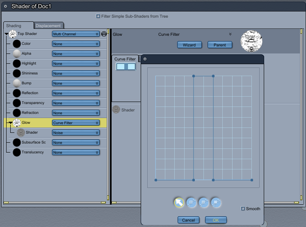

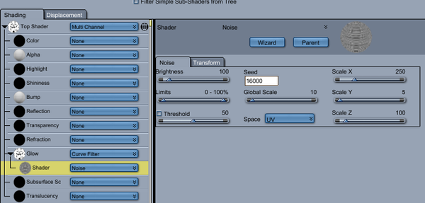

    Try using a noise or other shader that can scale one axis much higher than the others, and animate the seed value. Use a curve filter or color gradient to change the greyscale to something you like. My example below is an animated .gif in case, so you might have to click it.
    Alternatively, you could create a few line objects and use them as particles. I think this would be a more flexible solution.

    Setting the Space to Local should make it seamless for a sphere or cylinder primitive.

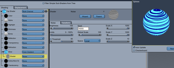

    I made the original shader for a plane, so I only worried about the scale in two axes. For a 3D object, you need to scale all 3 axes. Scale 2 larger and one smaller. You might have to change the global scale depending on the size of the object and its distance from the camera.
