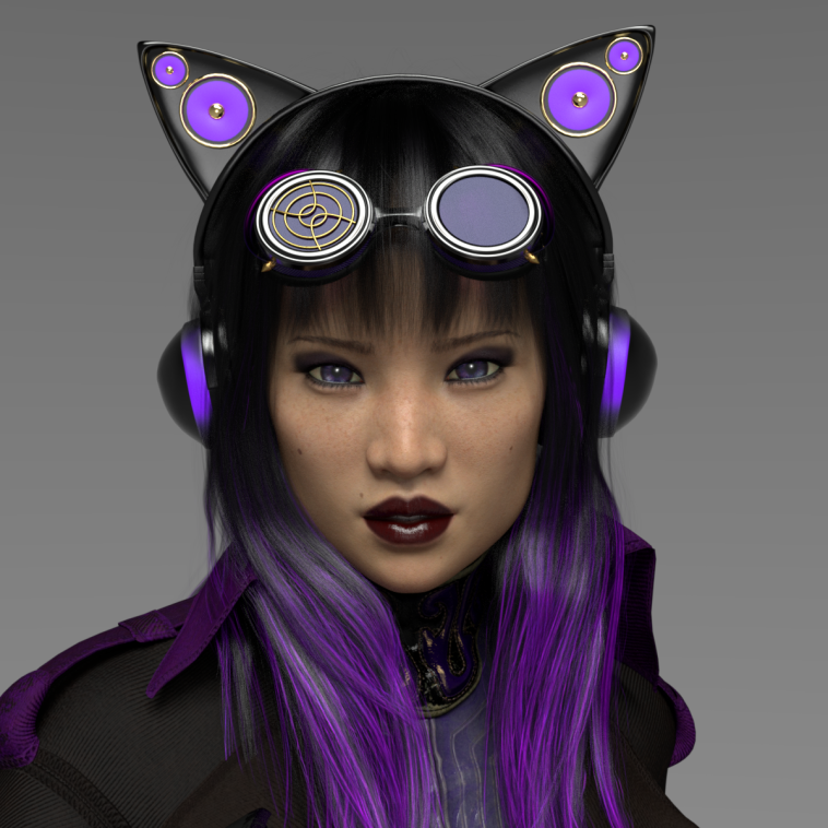

I would start with PRO-Studio HDR Lighting System. This is my "go to" lighting whenever I want to make a portrait style render (like the one below). The HDRI images are hand created to mimic the 3-point system that MDWhitney mentioned.
Since they are HDRI, they won't have quite as much specular light however, so if you REALLY want to go the next step, adding some spot lights may be worthwhile too. In my signature, I have a link to an old tutorial I wrote about setting up a 3-light rig. Although it was based on 3Delight, the principals are the same.
For that matter, for people/portrait renders, learning how photographers setup lighting for a portrait shoot and figuring out how to mimic that in Daz Studio would also be useful.I have always loved lighting in 3D; so I'd be happy to answer specific questions.
