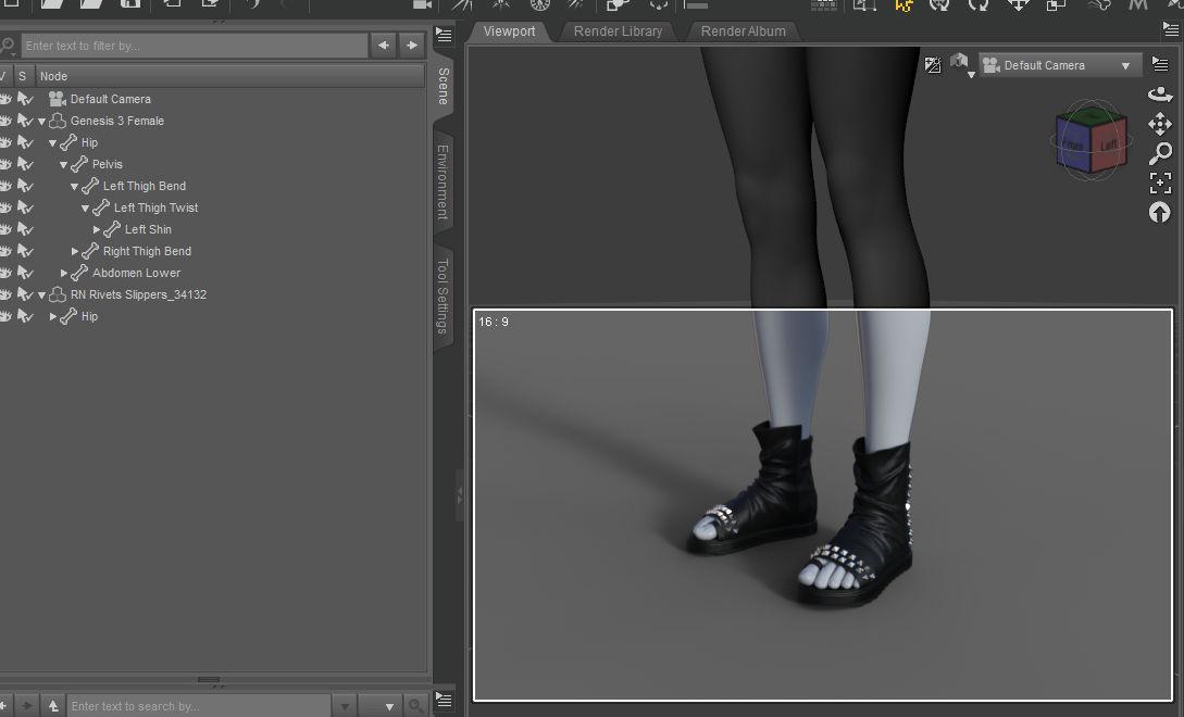

I bought Rare n Nirv Shoes Collection 2 for Genesis 8 Female(s) knowing full well that I intended to use it for G3. As I expected, the autofit clone worked, but had some issues, so I decided to try to do it my self.
I loaded the shoes on G8F then moved the legs into the default G3 position. Then I converted the shoes to a prop and used the transfer utility to fit them to G3F. It worked almost perfectly, just a little deformation when moving the toes, but that can probably be straightened out by adjusting the weight map. The only problem is that they don't have any of the original morphs the G8 shoes had. Is there any way to transfer those morphs to the G3 version? Or should I just leave well enough alone?
