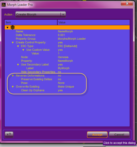

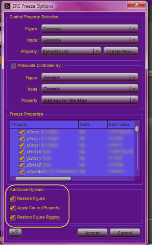

Hit and miss ... one day I might get the right combo ... so thought i should maybe drop in and ask ... what am I supposed to be checking off here please.

  • Richard HaseltineRichard Haseltine Posts: 111,348
    Reverse Deformations removes the pose/morphs applied to the figure from the morph, leaving only the changes needed on top of those to achieve the shape. The Pose option allows you to select a preset, so you don't absolutely have to have the figure in the state you want to reverse from. I'm not sure on the Preserve Existing Deltas option's purpose. The Overwrite existing allows you to load a new morph (the default) or to replace a current morph with the same name (useful if you are refining a morph); generally you want either Make Unique (new morph) or deltas Only (replace the morph leaving links etc. in place) but if for some reason you want to clear out the ERC (if you have managed to integrate a fix morph into the main morph, perhaps) you might want to replace the ERC too - I think the orphans option is to remove any left-overs after replacing the ERC, though again I am not certain.
    On the ERC Freeze options - essentially they remove the changes you were freezing, so that the ERC can take over. Restore Figure clears the pose and shape settings, Apply Control Property sets the new controller morph to its on value (so if both are set, and you didn't have any changes not related to the ERC, there'd be no visible change but instead of having multiple properties set you'd have just the master controller). The last option resets the joint centres to their default values, so if you used ERC freeze to link a morph to moved joint centres and set the second option you'd end up with the same result as before the freeze, but the only actual parameter setting on would be the morph that needs adjusting for.
