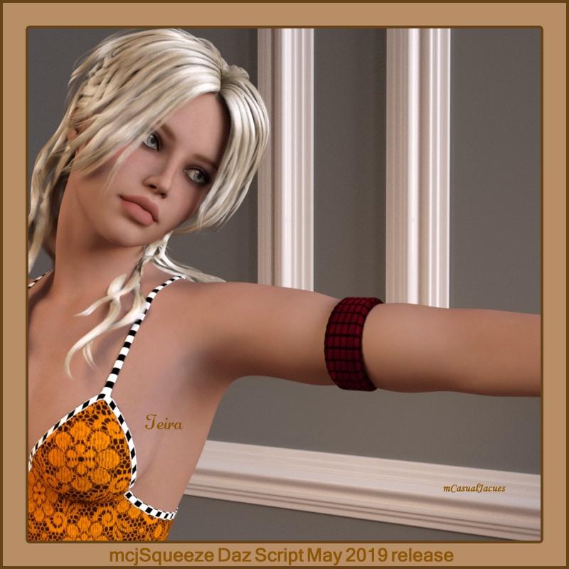

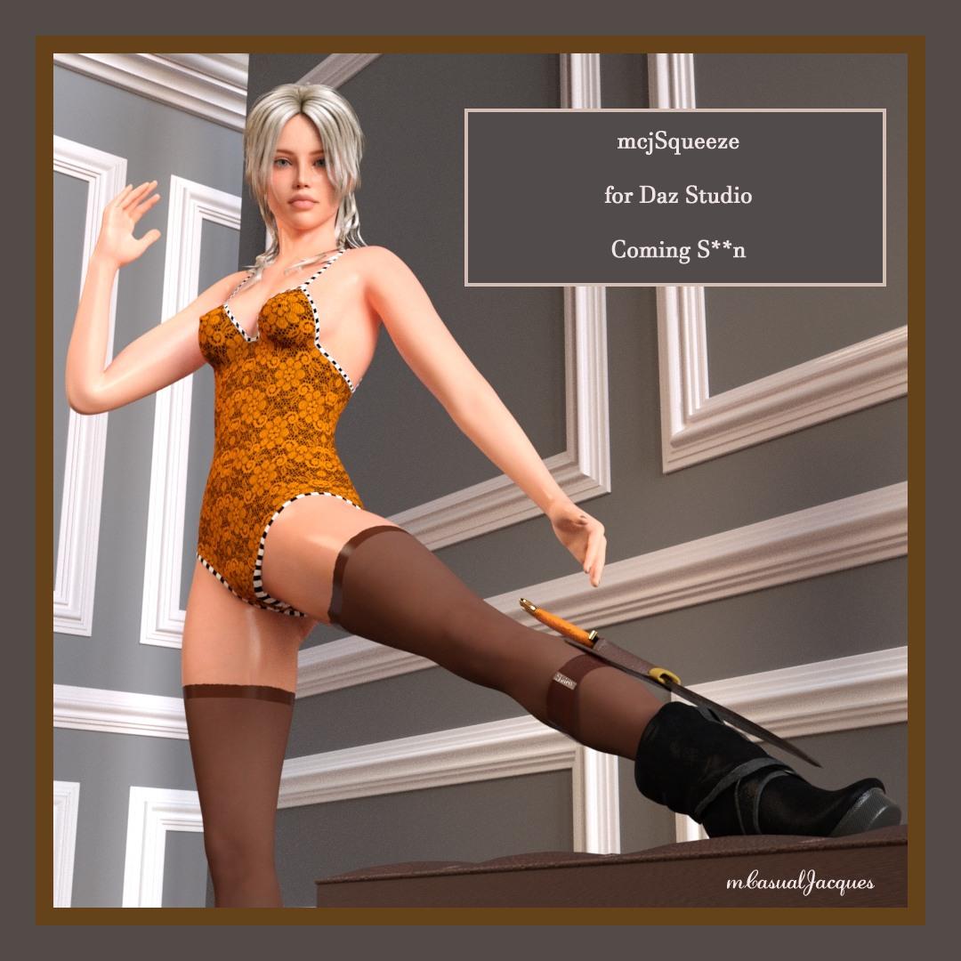

mcjSqueeze is ready !!!
( figure must be zero-posed for the morph creation but hey better that a kick in the, i mean better than nothin )
https://sites.google.com/site/mcasualsdazscripts9/mcjsqueeze
