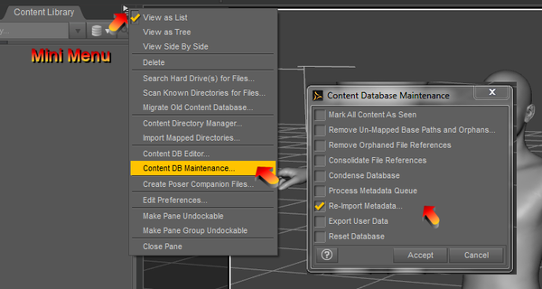

  • JaderailJaderail Posts: 0
    Here this will Help I hope...
    747 x 399 - 54K
  • UVDanUVDan Posts: 112
    Thanks, I have never seen that menu. I will have to try that.

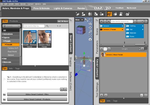

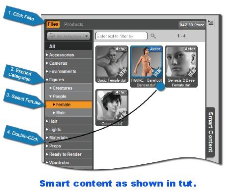

    That did not make my content match the tut. Here is a screenshot of the smart content interface in the tut compared with the smart content as it appears on my computer. I do not see Genesis 2 Base on my machine there either.
    499 x 357 - 58K
    459 x 388 - 60K
    Post edited by UVDan on

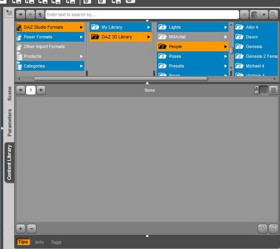

    It's one of the reasons why you can also access your content library directly (so without using the database). You can do so by using the previously mentioned "content library" tab. You can find it under the Window menu, select "Panes (tabs) -> Content library" (it's probably located somewhat in the middle).
    Now, select "DAZ Studio Formats", then "DAZ 3D Library" and then "People". Now you should see something somewhat matching the attached screenshot. At the very least should you be able to see "Genesis" and "Genesis 2 Female". If that's the case then your problem is most definitely caused by an out-of-sync database.
    691 x 616 - 36K
  • fixmypcmikefixmypcmike Posts: 19,719
    You have Genesis selected in your Smart Content tab -- you need nothing selected or Genesis 2 Female selected..
    Thanks everyone. Fixmypcmike I am still looking for the genesis 2 figure.
    Ok I finally found the Genesis 2 female in the content tab and then I was able to get the Barefoot Dancer to show up in the Smart Content. Whew!!! Thanks a lot to everyone!
    800 x 562 - 119K
