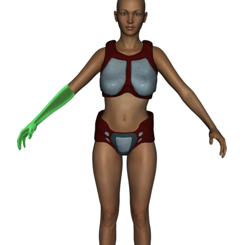

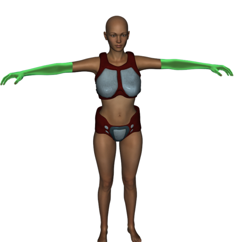

    If you use the Surface Selection Tool (Alt+Shift+M) to select the arms and the hands, you can then apply a shader to the areas that you want to use. I thought I had a lava shader, but I can't find it for the moment, so I used LJStudios 'Christmas Green', just to give the idea.
    When using shaders, you MUST select the item in the Scene pane AND in the Surfaces pane. You wont see the effect properly until you render, as the OpenGL viewport can't display shaders properly.
    This is Riley on Genesis, with some clothing for decency's sake.
    767 x 766 - 181K
    Post edited by JimmyC_2009 on

    Problem solved, thanks Jimmy!
    Yeah, it would be a very good excuse for me to finally pay a little more attention to shaders. But the thing is, as you showed here yourself, shaders can only be applied on surfaces (obviously).
    When it comes to Genesis you basically have 2 surface groups for the arm and hand: 3_SkinForearm and 3_SkinHand. The problem, as you showed yourself, is that if you apply a shader on one of those it will apply to both arms / hands. Which is not the effect I'm after; I want to focus on one arm only.
    But this tip did show me where things went wrong in my example above. The moment I use the surface selection tool (which I should have done from the start) and then use the control-doubleclick method to apply the material it does work. Of course now it applies to both arms and hands, but that's something I'll have to worry about later.

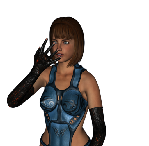

    Well, here's a quick preview. As you can see the lava material from the rock demon looks really menacing on Riley (and I love the diversity you have when it comes to facial controls).
    616 x 601 - 232K

    There may be another way to just texture one arm, Use the Polygon Selection Tool (Alt+Shit+G)right click on the arm and use Polygon Selection > Mode > Rectangule Selection. Drag a box over the arm, and when it is selected, choose Polygon Assignment > Create Surface from the same right click menu, and give it a name. It will then appear as a selection in the Surfaces pane, and you can apply a shader to that area only.
    Here is my example :
    767 x 766 - 262K
