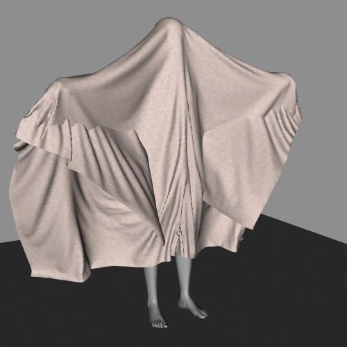

    I have just tried to use it on V4 on a sofa, and the whole thing seemed too much for it - DAZ just crashed. I then tried it with V4 alone in the T-pose and it threw up an error message:
    Cloth Simulation Error
    There was an error during simulation. This could be caused by setting cloth parameters to values that are too extreme. Try adjusting settings and draping again.
    I tried it again, but this time with Genesis. At least it did not crash, but the sheet did not bother to collide with itself even though it was instructed to do so (see attached).
    I'm using DAZ 4.6 on a 64-bit Windows PC and have the Dynamic Clothing Control, but with default settings.
