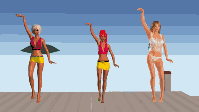

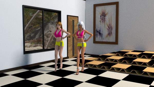

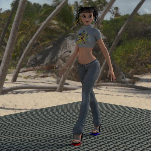

in the animation shown below i applied 6 ( poser ) poses to Aiko
with a 30 frames spacing
The poses were designed for characters wearing flat shoes
so with high heels the feet poses didn't make sense
i bent Amy's toes 50 degrees, which is the standard for these shoes
i deleted all the toes animations
and i locked the toes
i wrote a script which computes and applies a foot pose that brings ( and keeps ) the toes parallel to the ground
this already makes the poses look good
then i wrote a script which keeps track of the lowest of the two toes
for each animation frame the lowest toe is acting as an anchor point.
the script computes and applies the hip position required to keep the toe at the anchor point
the result is that the feet no longer slip slide and hover below and above ground
640 x 360 - 686K

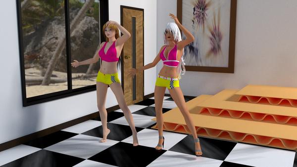

  • mCasualmCasual Posts: 4,607
    well since Darcie ( Aiko4's ) joint rotations are different from Amy's ( Aiko3 )
    i need a bit more time to figure this out
    1280 x 720 - 189K

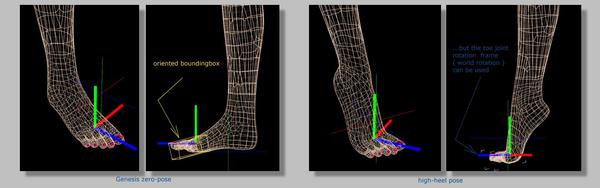

    for programmers
    obtaining the oriented bounding box corners
    node = Scene.getPrimarySelection()
    obox = node.getWSOrientedBox()
    box = obox.localBox
    t = obox.transform
    v = t.multMatrixVec( box.min )
    debug( v.x + " " + v.y + " " + v.z );
    Scene.findNodeByLabel("p1").setWSPos( v );
    v = t.multMatrixVec( box.max )
    Scene.findNodeByLabel("p2").setWSPos( v );
    but that's not enough, i want to know the Y axis/vector of that box
    think i got it
    box = obox.localBox
    t = obox.transform
    v1 = t.multMatrixVec( DzVec3( 0, 0, 0 ) )
    v2 = t.multMatrixVec( DzVec3( 0, 1, 0 ) )
    v = v2.subtract( v1 )
    it gives me a credible up-vector for the oriented toe box
    [ 0.008, 0.95, 0.009 ]
    edited November 2013
    well it happens sometimes
    DS4 and/or genesis have substantial differences
    so ... tomorrow i'll tie the loose ends
    and the scripts will be usable for all versions of Daz Studio and all human figures
    at least that's the plan :)
    ( specifically the issue is, Genesis toes have an oriented bounding box that's parallel to the top of the toes )
    ( also ... apparently i cant obtain correct oriented bounding box from a non-active frame )

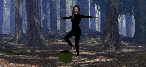

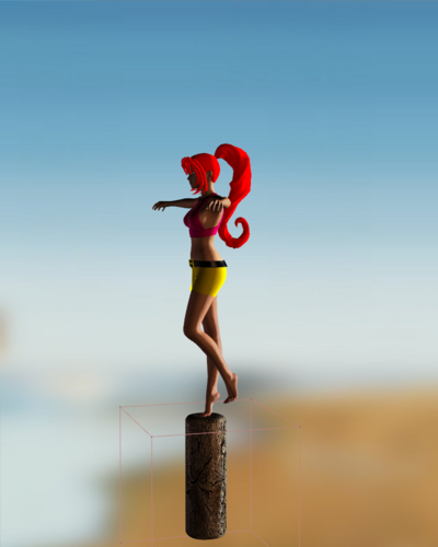

    the adjustment will be done according to the current position of the selected toes when the script is launched
    so your job will be to set the toes the way you want them in relation to the ground
    then the script will replicate that orientation for all the key-frames you want

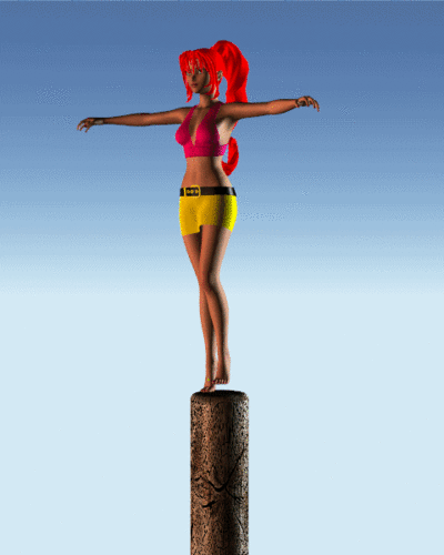

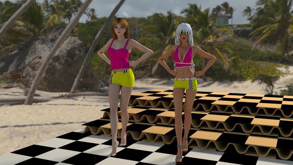

    yay it works for DS4.5 and Genesis
    now i have to make sire it still works for Generations 3 and 4
    and make it usable for various shoes
    in the 30 frames animation here,

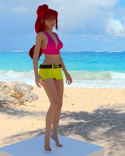

    i posed Aiko5 at frames 0, 15, 30
    the two upcoming scripts took care of the 28 other frames
    so the side-to side and up-down hip movement are a creation of the scripts!

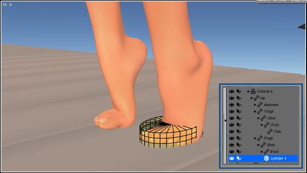

    there you go

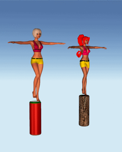

    Aiko3, Aiko5/Genesis, Aiko4 ( more like Victoria 4 )
    doing the oft-fabled toe-driven dance
    figure 2 - using "toe stand-ins"
    as long as they are parented to a foot they are treated as toes
    useful for shoes that bend the toes ( in relation to the ground )

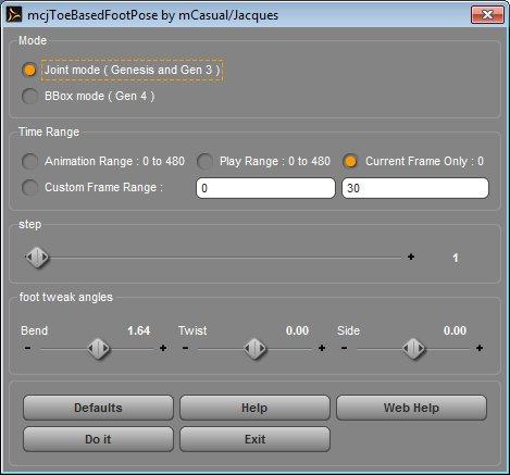

    figure 3 - the user interface ... it's almost ready !

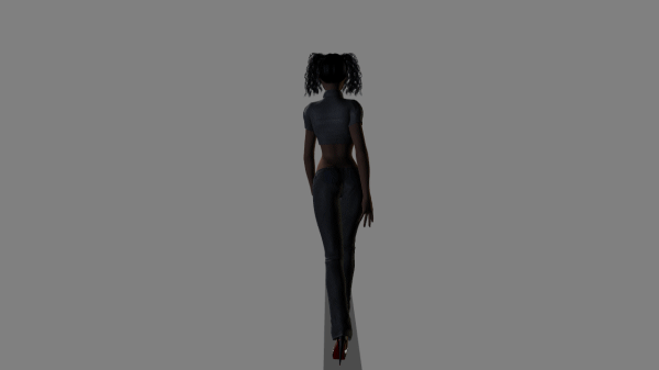

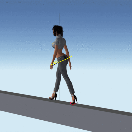

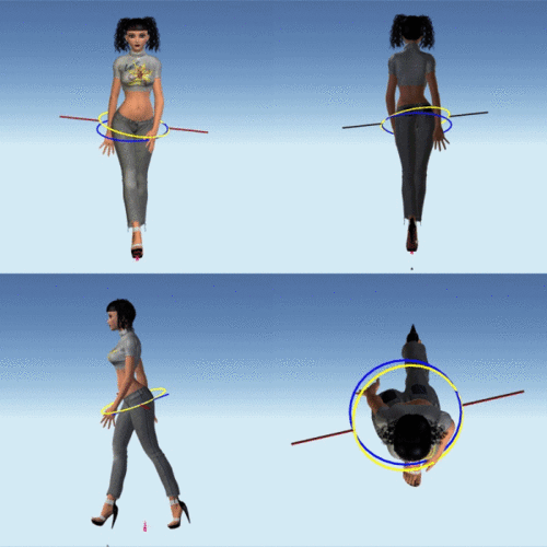

    walk cycle done with the help ( among others ) of the 2 scripts
    from this angle the walk look okay'ish but from other angles ... not really
    i want to publish the 2 scripts in the next hour
    600 x 337 - 110K
