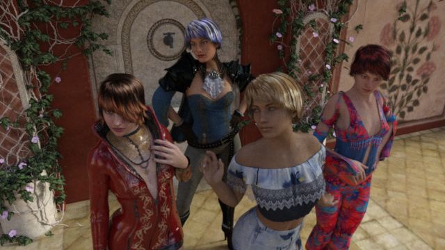

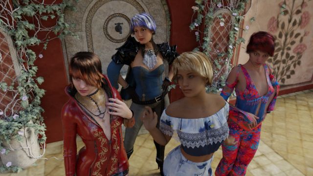

    Just to show something .. Below are two renderings of the same scene. The first is iray and the second is cycles with the diffeomorphic plugin. I did not touch anything. Just exported and rendered. You can see that materials, even skins, match quite fine. There's some difference in the foliage though that appears brighter in cycles. Also cycles is much faster and takes less vram being tile based, that means you can render larger scenes with the same card.
    EDIT. I forgot to tell .. the only thing I did in daz studio is to resize the textures to save vram since I really don't need 4Ks. And also because imho it's the only way to survive the iray hunger for vram. I also converted materials to uber shader to be more iray friendly. That's quick enough to do with xnView and the daz studio surfaces pane.
    EDIT. For the sake of completeness it is to be said that I used the stable release versions of both daz studio and blender in my comparison. This is mostly because I don't like wasting my time with betas and driver issues. If you use the daz studio 4.11 beta it implements a nvidia denoiser so the rendering times get comparable with cycles. It is also true that if you use the blender 2.8 beta it implements eevee so you get real-time pbr and your rendering times fly away. Apart rendering times though, blender has much better animation tools and physics simulation and fx, so for animation and general use I like it most.
    daz studio 4.10 render time 5m 09s (15% convergence) memory usage 2930M ram 2300M vram
    blender 2.79 render time 0m 34s (64x samples + 8x denoiser) memory usage 2870M ram 1700M vram

    I notice you said you used the denoiser in Blender, but you compared it to Daz 4.10 which has no functioning denoiser. That's not exactly a fair comparison. Either compare using no denoiser in Blender, or compare to Daz 4.11 with denoising enabled. It might not reach the same time, but it will be much more competitive.
  • PadonePadone Posts: 4,347
    edited April 2019
    I totally agree with you .. indeed while you were writing your post I was adding a note to mine about this issue. My purpose was to compare two final renders. Since 4.10 doesn't have a denoiser my best choice was convergence. As I said in my note above if you get betas then eevee flies away compared to a denoiser, though with some pbr limits. So overall I feel the gap between daz studio and blender rendering times will still there nonetheless.
