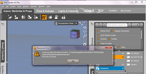

    I am starting to remember why I gave up on DS a couple of years back..... now my head hurts all over again:P
    I followed your instructions but I can't get V4 to load and now the stock Genesis figure will not display properly, just get a stack of boxes piled up in a human shape.
    Would I be better off uninstalling this mess and starting over with a custom install in a non protected location like D:/Daz
  • JaderailJaderail Posts: 0

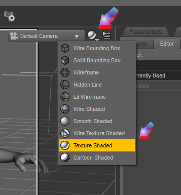

    I'm sorry I'm still writing a tut for you but your Genesis thing is you have accidentally changed your settings in the Viewport. Look here and that will fix you right up. As for V4 Open the Content Library Tab and look in Poser Formats>My Library>Figures>Daz People that will hold your V4 figure. Look in Daz Studio Formats>My Library>People> and you will find most of the other content. V4 is an older model and Should be found there. Here is your Fix for the Boxes.

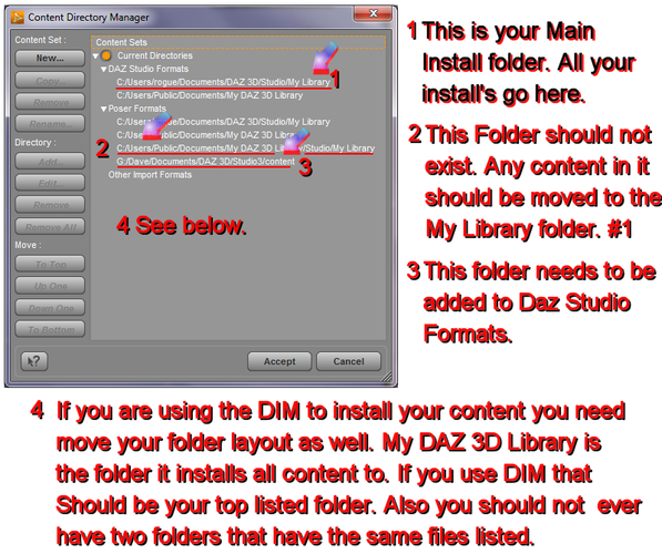

    I'm with Mike I do not believe your content folders are set up properly. I also doubt if your Content Paths in DS4.5 are set up properly.
    Could you go to Content Directory Manager and Expand your folders and post a screen shot? Here is mine on my Win7 .

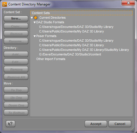

  • edited December 1969
    Ok after a bit of searching I found the content manager, here is the mess I have created, you will likely be able to explain how to fix the error in the second screen shot by looking at the first.
    G:/ is an external drive that I had backed up some files from my last attempt to use DS.
    edited March 2013
    This should help. And yep it's a bit of a mess. I'm very tired, so if you need more info on this please ask.
    In #4 by top listed I mean listed as BOTH the top in Daz Studio Formats and as Poser Formats. All folders that have any Daz Studio only content need to be listed in both.
