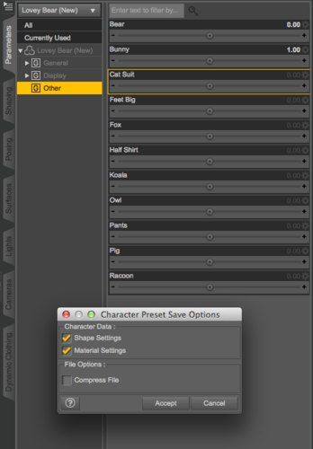

I am trying to convert and old figure, Lovey Bear Re-energized to a TriAx Weight Mapping and save it in the DSON format. That is the easy step. What I am not figuring out is how to save a Character preset after apply some MAT & MOR poser preset. If I load my converted figure and apply an existing MAT & MOR.pz2 preset, it works fine.
So I save this as a Character preset checking Material settings and Shaping settings in the Character Preset Save Options dialog box. When I load the converted figure again and apply the saved Character preset, just the surface settings are applied and the shaping is ignored. Obviously I am missing something when doing the conversion. Can someone help me with the correct workflow?

    The morphs have the wrong content type, they need to be flagged as "Modifier/Shape" before the Character or Shaping presets will record their settings.

    Thank you so much for the answer, this made the trick. Yeah, I know that "convert figure to weight mapping" is not the Holly Graal, but the items which I am converting were very simple and will not be worst than before. Lovely Bear is a very simple figure and I can take the time to learn a little more about the weight map brush and all other tools.
