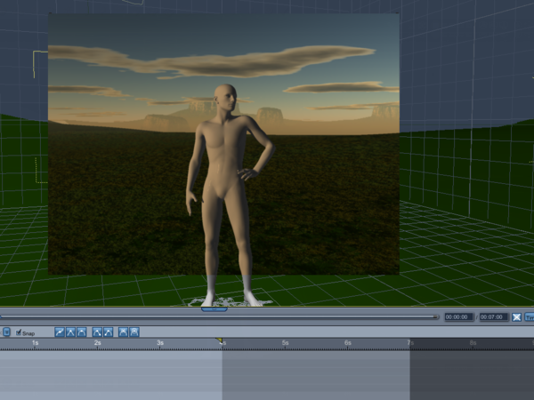

However, whenever I zoom the camera in close enough to see the figure, the horizon line ends up at about chest level with the figure, with the sky above it, black between it and the actual horizon of the terrain. I have not been able to figure out how to "lower" the sky horizon to actually be at ground level. I can get the "sky" to do this, but it doesn't look as nice. Does anyone know if the horizon can be adjusted, or fixed to not show? Is the realistic sky only supposed to be used with "large" scenes, or landscapes rather than figures? I can upload pictures of my renders illustrating this later if it would help. Thanks in advance!
Rich S.
    I believe that it's Carrara's method of defining the horizon line a bit. I usually just hide it. In this case, I'll demonstrate two natural ways of doing that:

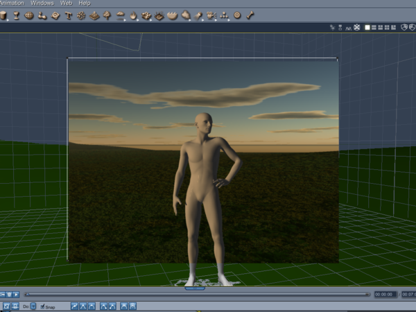

    In the First image below, you'll see that I have that dark line at the horizon, like you say.

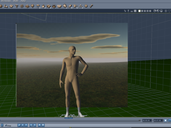

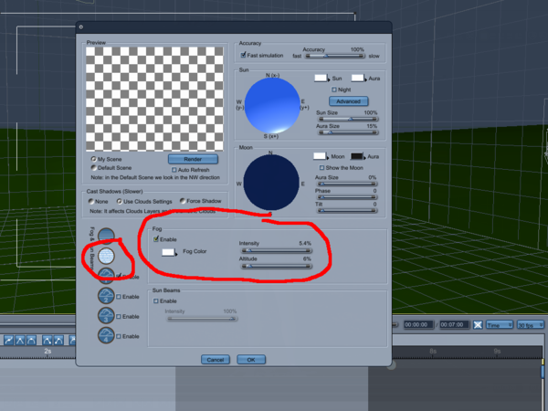

    The next image shows that I am in the Realistic Sky Editor. The smaller red circle on the left is the button you press to enter the Fog and Sun Rays controls. The larger circle are the fog controls. I have turned the fog on, left the color at default, but lowered the settings from their defaults to make the fog appear farther away from the camera. So the third image shows the result in the spot render.
    1024 x 768 - 458K
    1024 x 768 - 147K
    1024 x 768 - 455K

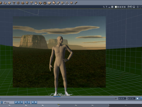

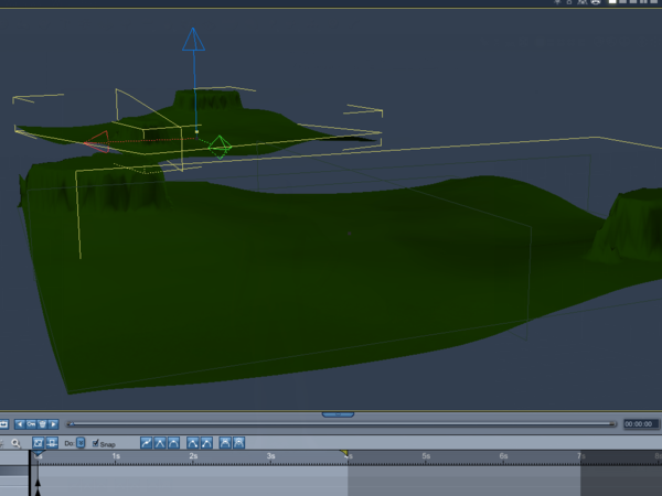

    A different way is to use terrain as your friend. For the above example, I just dragged in a plateau from the browser and moved it down a bit, so it was in a good position. This time, I'll turn the fog setting back off, so we can see the results of this second method.
    I select the terrain and duplicate it (Edit > Duplicate or Cntrl (Cmd) + D)
    Now i go into the Director's Camera (upper left of the main view to switch cameras) and, with that new duplicate selected, type 0 (zero), which will put the whole terrain in view. I push back the terrain behind the subject and rotate it around a bit.***
    The first image shows me in the Director's Camera placing the duplicate, the second image shows what it looks like in the film camera.
    Not too bad. I duplicated that one, and slid it to the side, grouped them (Edit > Group or Cntrl + G) so that I can move and scale them all together. So the third image shows it with just that one more duplicate.
    *** You may, of course, use anything you wish to extend your horizon line. This way was shown because it's fast, simple and, since it's using "Duplicate", it's friendly to your system - as it's just an instance of the original.
    1024 x 768 - 471K
    1024 x 768 - 506K
    1024 x 768 - 96K

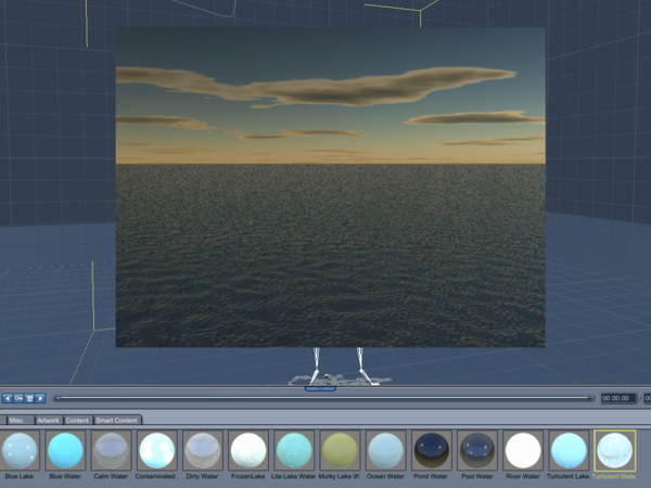

    Here is an example of what happens to the horizon when an infinite plane is inserted (using the insert menu) and left in it's default location, which is ground zero. You can see that the infinity of the ground level in Carrara hides that line.
    1024 x 768 - 616K

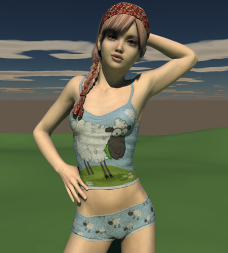

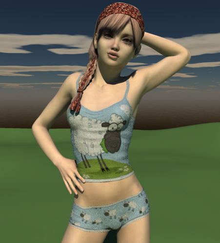

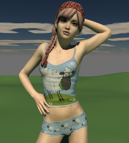

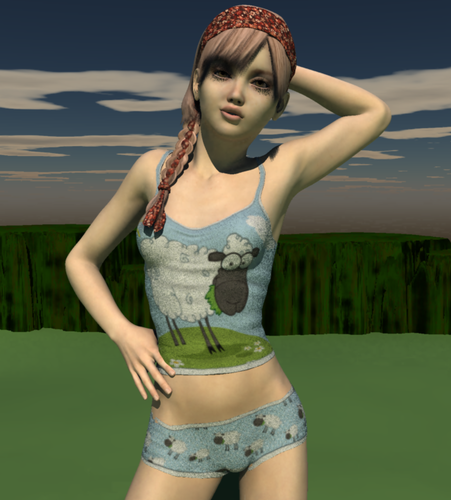

    I finally got some time today to try these techniques, using Teen Josie and a simple render. I have made several pictures to illustrate my results. I had asked a question about the line earlier, and someone mentioned raising the horizon value really high in the realistic sky, and that does get rid of the line, but the gradient fading to black towards the ground is still there.
    So the first picture is the render before I tried any of these techniques, with the ground layer of the realistic sky "on." You don't see the gradient or black line, but the ground is rather visually jarring.
    The second picture is the same render, with the ground off, showing both the line and the gradient.
    The third picture shows the ground off and the horizon of the realistic eye raised really high. So the line is gone, but the sky still fades to black as it approaches the ground.
    The fourth picture is my attempt at Method 1, with the fog it works nice, but you can still see there is a difference between the fog area and the ground. It looks better, but still not right?

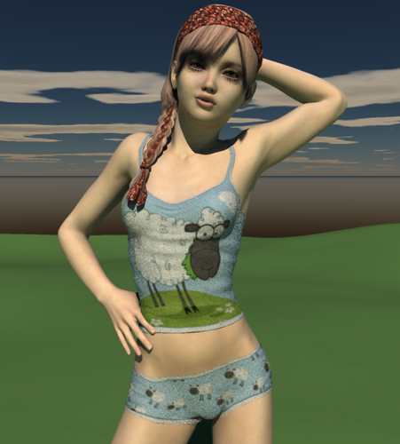

    The fifth picture is trying Method 2 with a plateau in the background. I had to have them much closer than in Dartenbeck's image, to completely cover up the gradient. Even then, the left hand side still showed the black line, so I raised the horizon and that his how I arrived at the attached image.
    I noticed in the sample pictures, the horizon is much higher in the background, allowing for both the fog and the plateaus to be lower or further away. In my renders, the horizon is about chest level in the background.
    Thoughts? Thanks!
    Rich S.
    640 x 709 - 361K
    640 x 709 - 297K
    640 x 709 - 311K
    640 x 709 - 302K
    640 x 709 - 299K

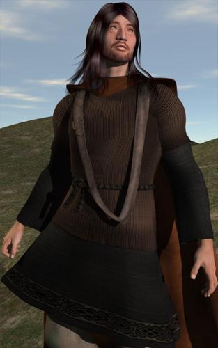

  • StezzaStezza Posts: 9,212
    The way I do it is by using either bought terrains with hill morphs or by creating one in the terrain editor..
    I make sure there are hills behind the subject and also the camera angles on the subject are from either above looking down or down looking up, I try not to use straight on views.
    Here is a quick example of what I mean.. ;)
    500 x 800 - 205K
