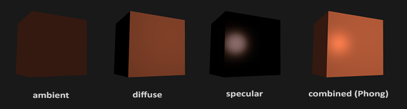

    Thanks friends, PBR guide states: The major building blocks of the Phong model consist of 3 components: ambient, diffuse and specular lighting. Below you can see what these lighting components actually look like:
    800 x 216 - 29K

     but in Iray you can't split them off like you can in 3DL. There is no ambient in Iray only light, Specular, Diffuse and Emission (light emitting). Well there is ambient obviously but it is automatic hard coded in the render engine.
