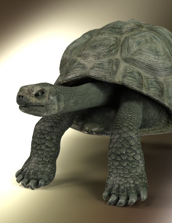

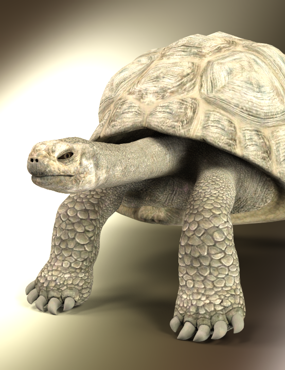

    I don't have the snapping turtle product so I couldn't test it on that to see if it will work, but here's what it looks like when I converted the Galapagos Tortoise:
    The 3DL mats it loads with:
    The mats after converting it with Altern8:
    The Galapagos Tortoise didn't have bump maps so I also plugged in the "Base Color" maps into the "Bump Map" slots to give it some bump texture.
    554 x 720 - 549K
    554 x 720 - 526K
