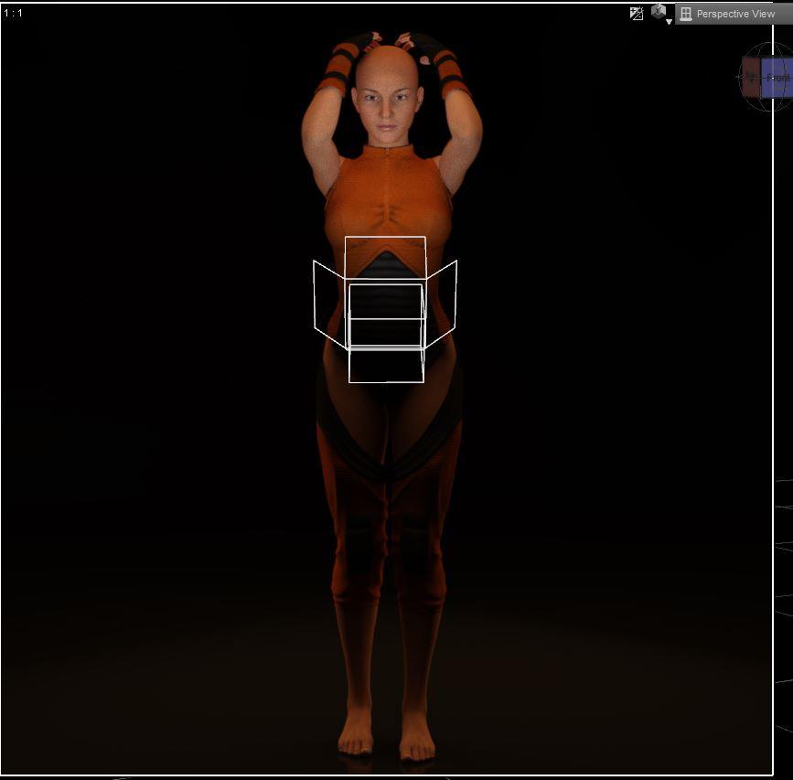

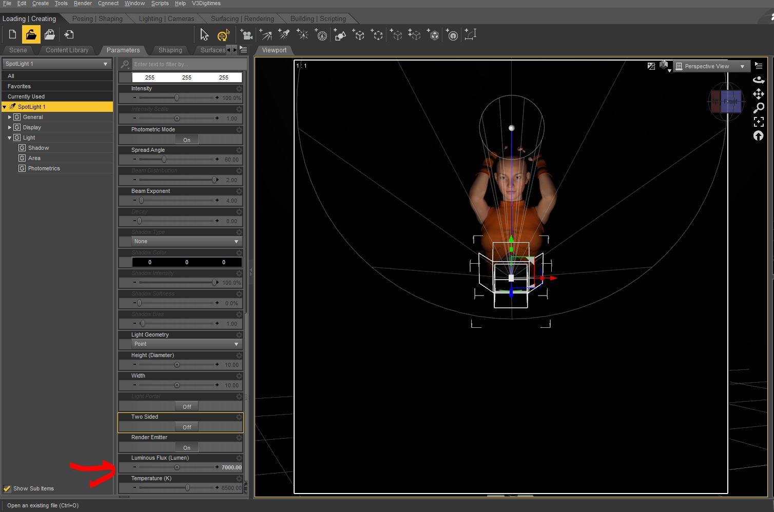

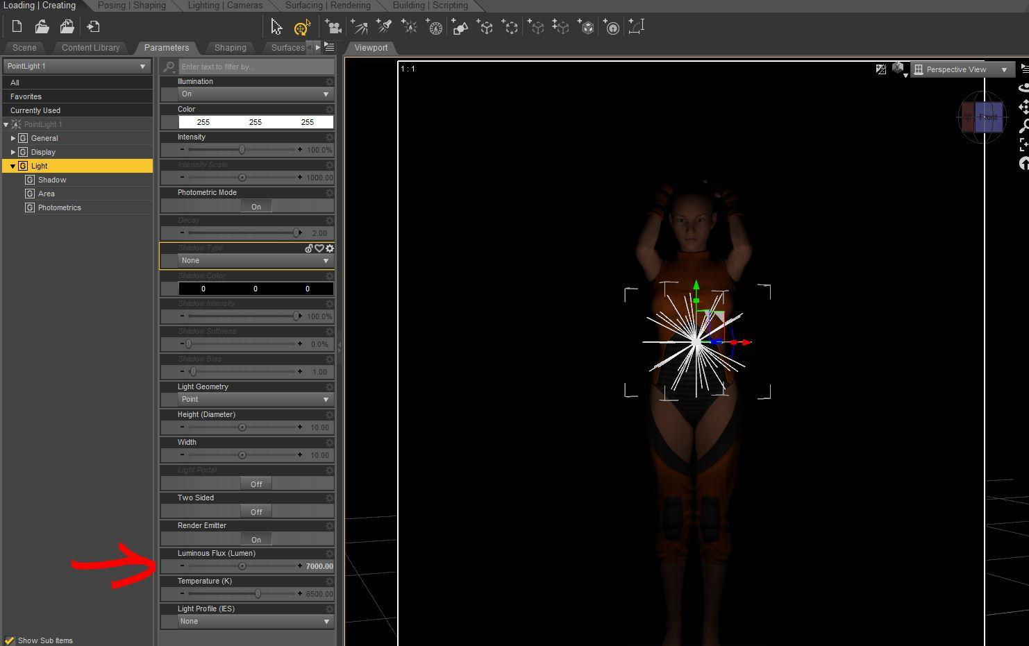

So, here are the comparisions - if you use just a plain pointlight at 7000lms:
Compared to a spotlight of the same strength in the same position:
As you can see, the spotlight gives a much sharper contrasted light compared to the pointlight. Also keep in mind that light in Iray behaves like regular light, so it decays over distance.

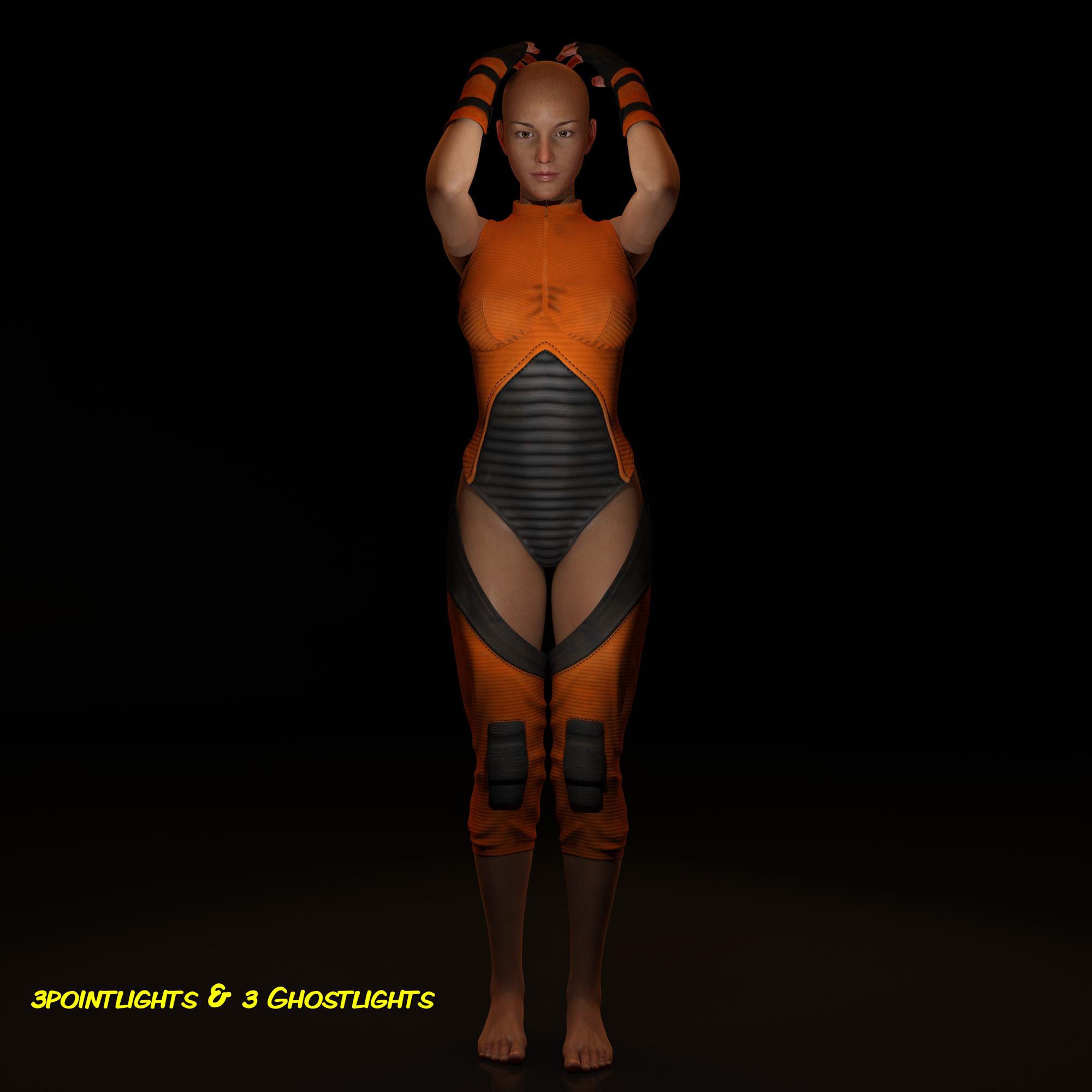

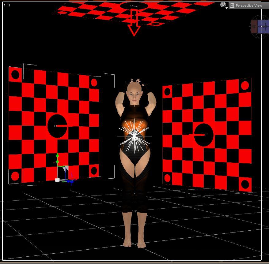

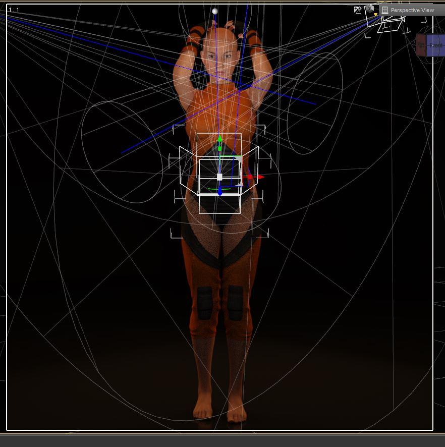

This is a simple test setup for 3 ghostlights and the upcoming renders with spot- and pointlights.
For the first two images, the point and spotlight are at the exact same position as before. Take note how the ghostlights contribute some gentle ambient light to the scene.
Ghostlights and pointlight:

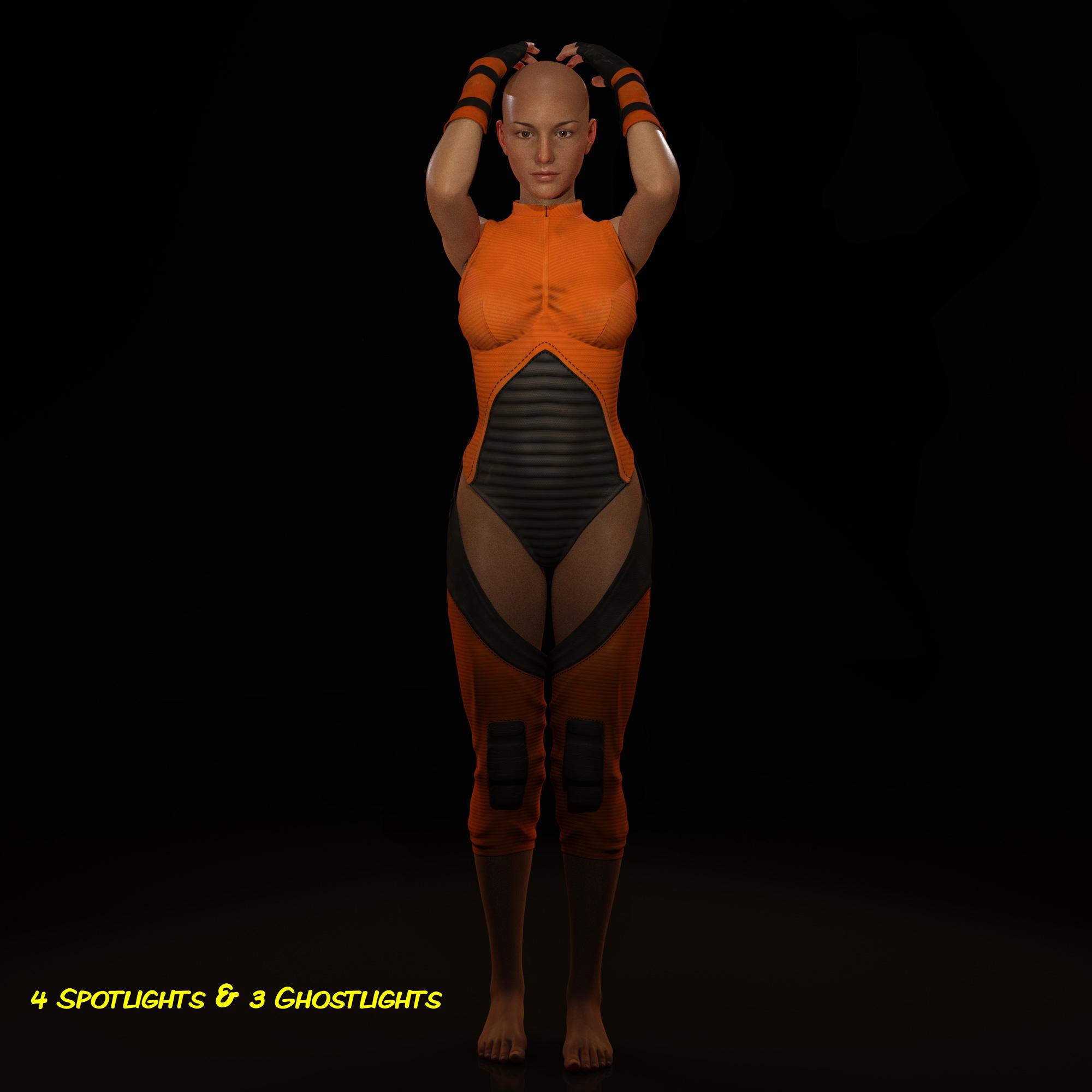

Ghostlights and spotlight:

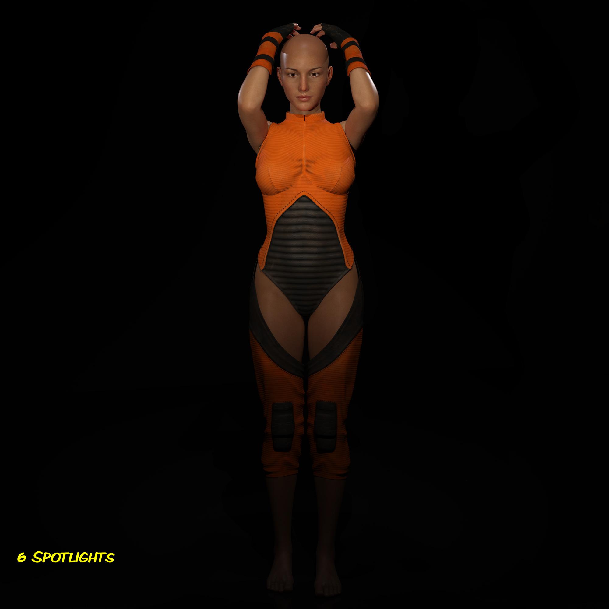

Now, I've thrown in 6 spotlights instead of one; as you can see, I'm using various angles from the front and the back of the character.
The effects of the diffferent light combinations are more obvious when you crank up the strength of the light a bit from the 7000lms.

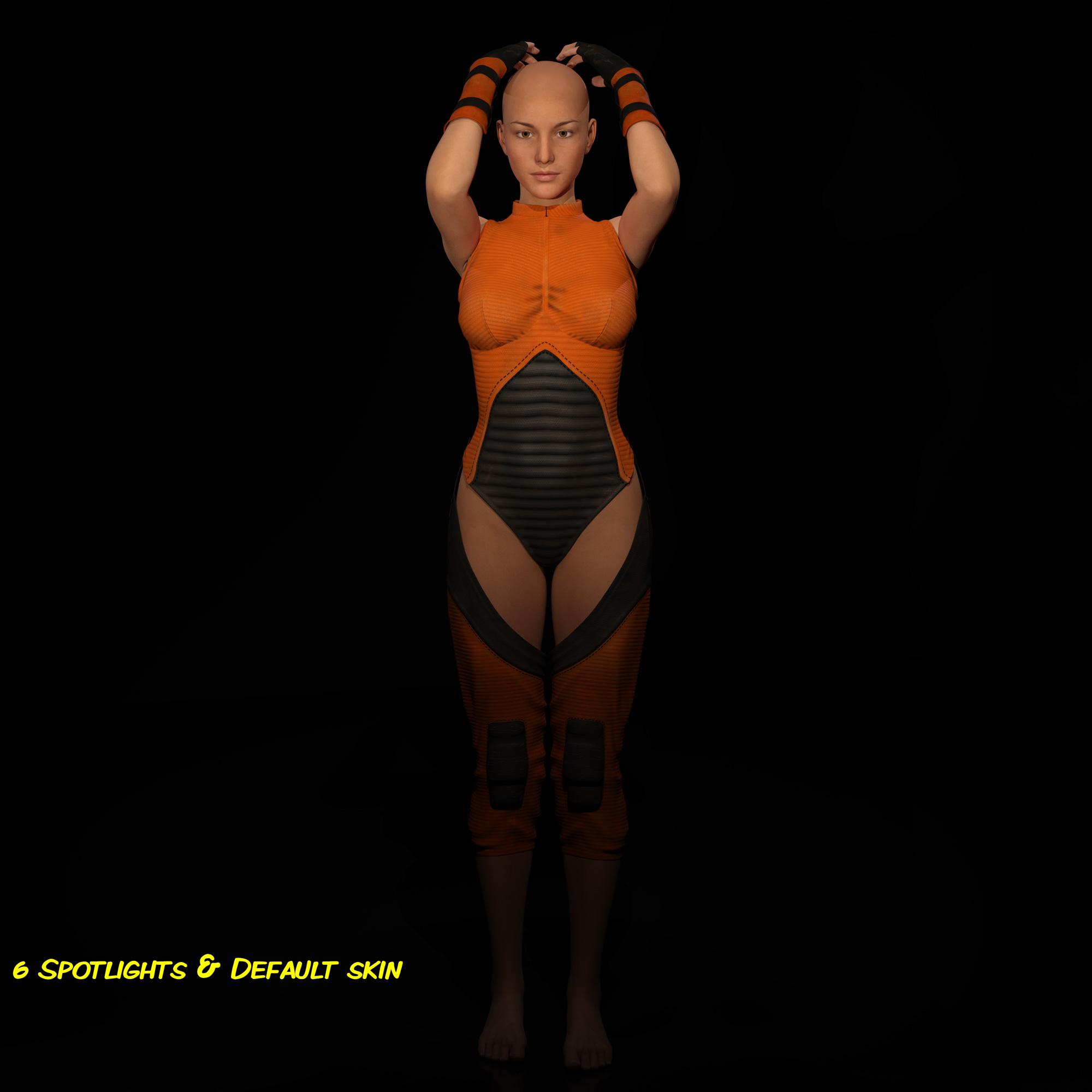

Finally, the skin makes a huge difference when it comes to flatness or not. The above three renders were done using the default G3F-skin with Altern8-Skin settings applied.
Here's the same 6-spotlight setting with the regular shaders for the skin.
Notice how much flatter the skin looks with the default skin shader settings? It's worth tinkering around with the surface settings as well to get the best combination out of lights and character.
Oh, and on a general note, the plain spotlights rendered fastest. Using ghostlights in combination with other lights sometimes causes a lot of graininess that takes a while to clear up.
