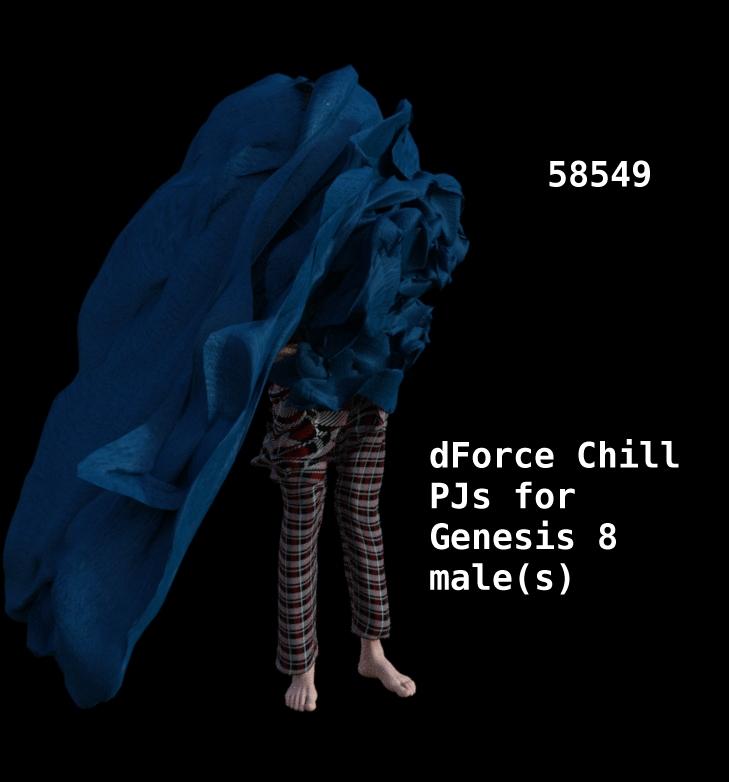

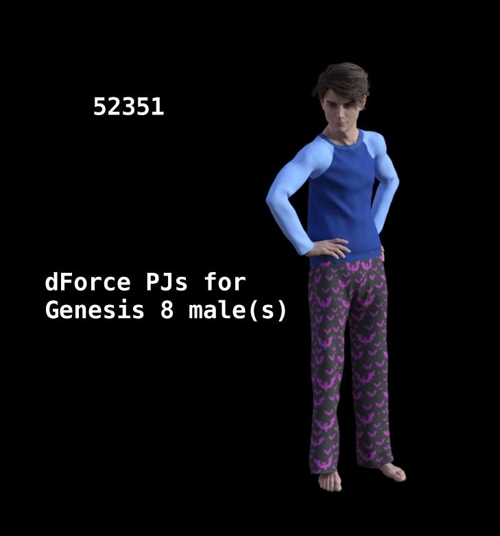

Comparing the newer https://www.daz3d.com/dforce-chill-pajamas-for-genesis-8-males- with https://www.daz3d.com/dforce-pjs-for-genesis-8-males
The dForce Chill comes off badly when I compared them, with the Chill shirt exploding. And, when loading, the Chill PJs top and bottom need to be manually fitted to the G8M, which is not what I expect with newer clothes sold here.
The older PJs by Nikisatez performed without a glitch using exactly the same character setup as the Chill PJs.

    I do have them, but forgot about them blush  Hmm, did a quick test using the same G8M character and pose, and the clothes fit-to okay, but exploded at the end of simulation and freezing Studio. There must be a spot where the cloth intersects with the character or itself, which indicates that https://www.daz3d.com/dforce-pjs-for-genesis-8-males is much more forgiving.
    Serene Night, I don't have the Relaxed Night Outfit yet.
    EDIT: The https://www.daz3d.com/dforce-pajamas-for-genesis-8-males caused Studio 4.10 to freeze, and when I shut Studio down then restarted, Studio crashed as soon as I tried to load anything. So I opened Studio 4.11 Beta instead, loaded my test character and made sure there was clearance all around. I added the pajamas aand ran a simulation and again the top and bottom exploded, but not as badly as the first test in DS 4.10. Here's hoping Studio doesnt crash again.

    I'm testig the Chill Pajamas now. I had G8M selected when I loaded the Wearable preset, and both top and bottom were fit-to the figure automatically. (Did you have G8M selected when you loaded the set? That might be the difference.)
    I found the pose you used so I applied that to my G8M and without changing any settings, I ran the simulation. At the end, it exploded for me as well. But I can tell you exactly why they explode. The default Simulation Settings start the simulation with the figure in the memorized pose. which for most us means the A-Pose when working with G8. There is a period of initialization that takes place in that pose, then the figure moves into the applied pose. At the very end, both hands move through the body to reach the position at the hips. While the hands are intersecting the body, they are also intesecting the mesh of the pajamas. And that's causing the explosion.
    When I turned "Start Bones From Memorized Pose to Off, running the simulation did not explode. His hands are intersecting the shirt, but it still didn't explode.
    I then changed the settings to use the Timeline, 31 frames, pose at frame 15. I modified the pose in several places to guide the hands to the hips without intersecting the body. When the simulation was finished, I used a bit of the Loosen Hips morph to expand the bottom of the shirt just enough to eliminate poke through.
    Give me a oouple of minutes, and I'll add an image.

    Please don't get me wrong, L'Adair, I'm not saying that the Chill PJs don't work, just that the older Nikisatez PJ's performed better. And the Relaxed Night PJs did badly.
    Unlike your simulation, I started mine from the memorized pose, with the only difference in the first three tests being the clothes.
