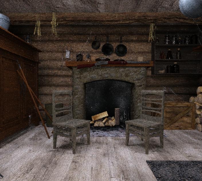

  • music2u4umusic2u4u Posts: 2,822
    Gonna try to make some lights. I have copied your instructions, lets see how it works. Later.
    edited March 2019
    I played with the ghost light kit a bit. I used two dome lights on this scene, one on each side of the room. You have to hide the lights or they will show in the render. If you hide them in the scene, they won't work in the render! This render would be otherwise completely dark. This is with just the two dome lights. No environment adjustments at all. These ghost lights work pretty good.

    edited March 2019
    You hid the lights? Wouldn't it be better to use the "Apply before presets" icon (Under "GLK materials" for Kit 2)? That makes the lights invisible in the render. Or are you using Kit 1?

    One thing to consider with your log cabin interior...generally if you look at a foto of a real log cabin theyre fairly dark inside, with maybe a couple of yellowish incandescent bulbs to give that warm, homey mood. Which is why I tend to steer clear of bright and/or fake environment lights unless absolutely necessary. And especially with dark wood walls theres far less bounce light from the window sunlight to brighten the interior.
    edited March 2019
    I pushed them outside of the scene border then rotate them to shine where I want them. If I turn them OFF, the light goes away.If I hide them in any tab, the light goes away. (Kit 2).

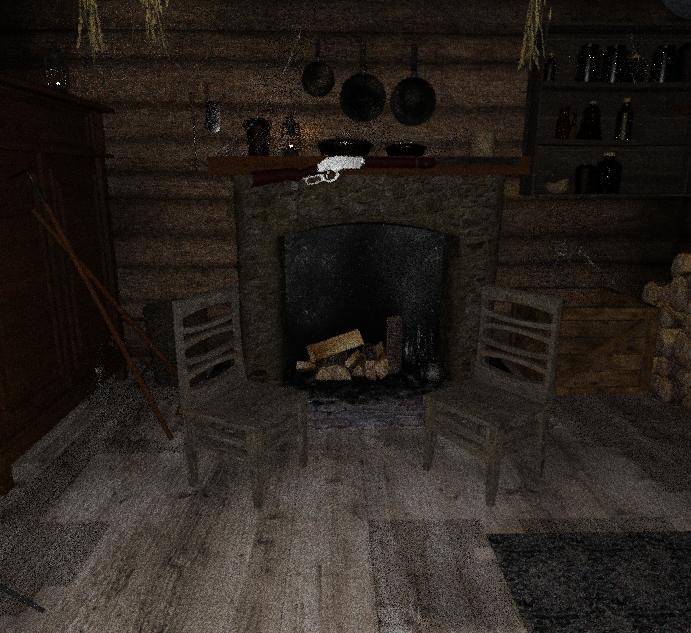

    edited March 2019
    OK...Here is what I got with the "hide" lights.
    This render has two dome lights up at the ceiling. They are both turned OFF in the show in scene display tab (hidden from view). They are both turned ON in the show in render tab.
    this is the result. Look at how dark it is.

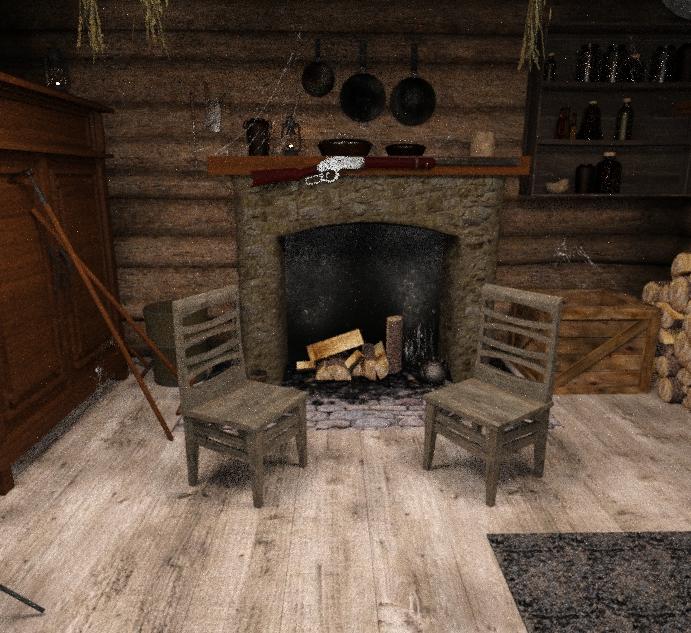

    edited March 2019
    Next, the same two dome lights, pushed up just outside of the top border. They are both turned ON in the show in scene display tab (You can see them, thus pushed out of the border area). They are both turned ON in the show in render tab. Now there is light.
    So...if I turn them OFF in the scene, I get no light. Like turning off a light switch. This is what I was trying to explain.

  • marblemarble Posts: 7,500
    edited March 2019
    BTW...I found the "display" tab in the Parameters tab, Not in the lights tab.
    I think there is some confusion here about "turning off" Ghost Lights. These lights are really just primitive objects with emissive surfaces, not "lights" in the sense that a DAZ Studio spotlight is a "Light". So you won't find them in the Lights tab. The parameters for them are applied in the Surfaces tab and the way to get them to light the scene without being visible in the scene is to use the controls I mentioned in my last post.
    Go to the:  Content Tab>Light Presets>IRay Ghost Light Kit
