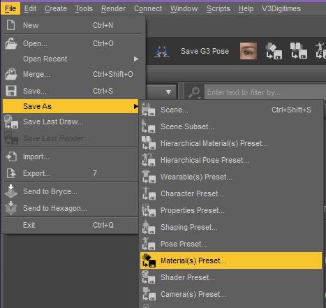

    Load Michael 4 and apply the materials/skin that you want to be able to use with Genesis 8 Male. Make any adjustments that you want to it (skin shaders, Iray conversions, whatever tweaks you want to make it look good). Once you have the skin looking the way you want it, save it as a Materials Preset (File >> Save As >> Materials Preset) and save it to a place you'll remember it. I usually save to Presets >> Materials.
    Make sure to save it with a name that is easy to find. The naming convention I usually use for Materials Presets is to start with the figure it's for, then the character the mats are from, then any adjustments I've made. So for this example I'm using the textures from Forest Daphni. So once I've tweaked it with a shader I've saved it as a Materials Preset and named it "V4 - Forest Daphni Mats with Altern8".
    Now load Genesis 8 Male, navigate to the Legacy UV product (it should be under People >> Genesis 8 Male >> Anatomy) and load the "Legacy UVs !Prepare Genesis 8 Male" script and then load the "Legacy UVs - Apply Michael 4 UVs". Last, navigate to where you saved the M4 materials preset and apply that to G8M. You should now have the saved M4 materials on G8M.
    Once you have the UVs and everything on G8M you can save it as Scene Subset to quickly load the figure in the future with the Legacy UV geografts and textures already applied. (File >> Save As >> Scene Subset)

    Here's one way to do it.
    Load M4 into the scene, apply the texture from the Poser Library or Daz Studio Library, wherever it is.
    Go to File>Save As>Material Preset. Save it to your Desktop, name it "M4 Gen8" or something. I just named it "Sol" because that's who I had used.
    Go to File>New.
    Load Genesis 8 Male.
    Click on the "Prepare Genesis 8 Male" thing, it'll load the Geografts.
    Go to Surfaces tab, select all skin and geografts, make it all the same color. I use just plain ol' white.
    Go to File>Merge and select your M4 Gen8 or "Sol" as I named it.
    Then select the next option with the package, I forget what it says.
    Should be good to go.
