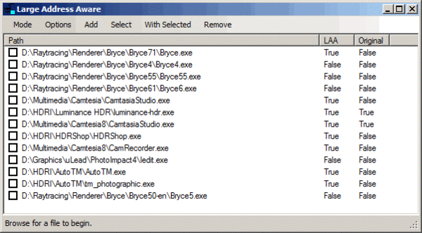

Lately I've been having a few problems with bryce yelling at me about 'Out of Memory' problems. In another thread I saw that:
Horo said:
If your computer sports 4 or more GB of memory, you can make Bryce large address aware (LAA) and thus give Bryce around 3.5 GB.
I have an Intel Core 2Quad CPU Q6600 @2.40GHz 2.39GHz
with 8GB of RAM
and it's a 64 bit Operating system...
My questions are:
1) can I use this Large Address Aware capability of Bryce7Pro's?
2) And if I can - how do I do that?
3) And lastly does it make a difference if I have the latest version of Bryce or not?
(I have 7.1.0.74 although I've downloaded the later version - but I've been putting off installing the newer version because of all the hastle of saving the Presets first... sigh.)
4) if I can do it with my current version would I have to do it all over again if I eventually do install the latest Bryce?

  • HoroHoro Posts: 11,686
    I've tested from Bryce 4 up to now all versions and LAA works a treat. Run LAA and click on Add to add any 32-bit program you wish to be large address aware. Here's a picture if you use Mode > Advanced. If you have added Bryce, select it at left, then click on WithSelected toggle the flag. This setting is permanent until you change it back.

  • franontheedgefranontheedge Posts: 342
    Oh thanks Horo, that looks useful.
  • StuartBStuartB Posts: 600
    Hi franontheedge. I have exactly the same processor but only 4 gig of ram and use LAA with no problems.
    Bryce crashes less often with LAA and never suffers out of memory problems.
