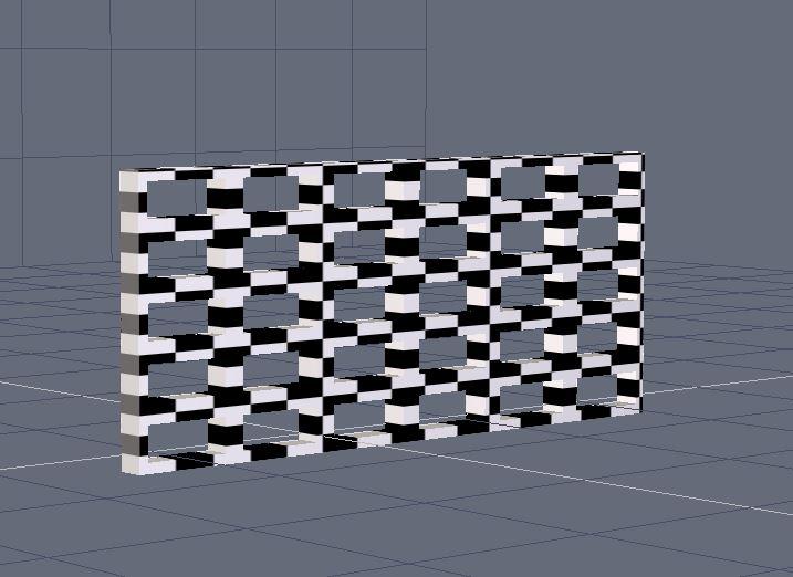

    what I do in Carrara and same as in hexagon is firstly create a grid
    maybe a 6 x 5 or whatever
    next  select all the edges
    next use the edge tool to extract edge around
    next select all the larger faces and delete them
    next I would use the thickness modeling tool to give it thickness
    and finally use the planar projection to uv map it.
    717 x 522 - 56K
