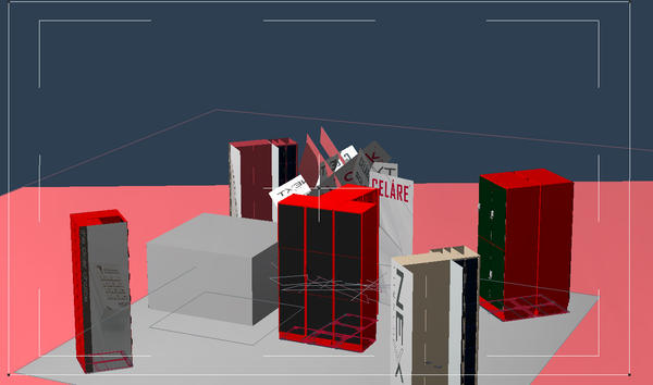

I've created a group of objects. and when I copy those objects to another document it's all in scattered pieces, as if i started to build it from primitives. I tried saving it to my objects presets library and when I drag that in a document it's all out of "wack".
I even tried placing the the exact place in the timeline and still everything is scattered and in pieces. Without having to un-collapse each objects settings in the timeline and manually removing the key frames.

    See if you can make an NLA track for the whole group, and then use the new NLA tab to create an NLA clip - which gives you the option to delete all keyframes in the process.

    1317 x 776 - 294K

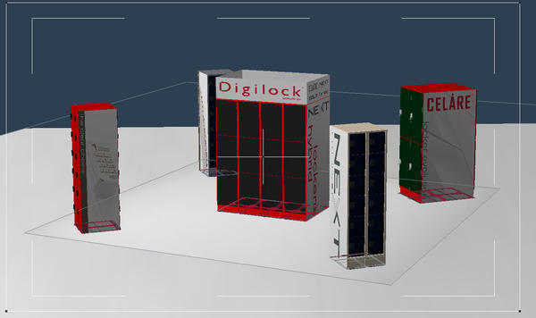

    This is what is suppost to look like. I had to manually rebuild it on the same timeline position
    1308 x 775 - 270K
    Yeah... sorry for the headache.
    It's always good practice to build your models and save them to the browser right away before moving them from point zero, and especially before animating them.
    If all else fails, go into the timeline and open all hierarchies by clicking all of the little white triangles. Then drag your selection around all keys except for those at timeline 0 (zero) (sometimes, deleting keys from timeline zero will delete the model, or otherwise break it)
    and then delete the selected keys.
