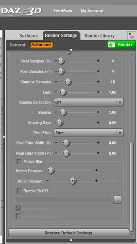

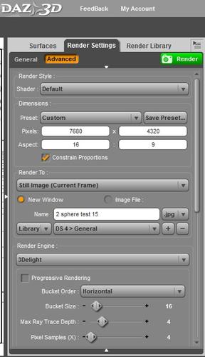

Why is it when I render an image at 7680x4320 and resize it to 1920x1080, it seems to have slightly more sharpness/detail than an image rendered at 1920x1080?
DS 4.6 with main distant light set to 150% intensity and Deep Shadow Map and 5 fill distance lights at 20% illumination diffuse only.
Using REYES (non-progressive render) and sinc pixel filter with a pixel width of 6.0

  • StratDragonStratDragon Posts: 3,290
    because the detail in the larger screen size takes into account the preciseness of the calculations that were necessary to make the larger image clear. The 1900xX render has a better opportunity to blur those calculations. Also the algorithm in the software that renders and the one that re-sizes don't necessary share the same method of arriving at the final product.

  • CypherFOXCypherFOX Posts: 3,401
    Greetings,
    I like to think of this method of getting slightly better detail in images as 'manual 4x anti-aliasing'. :)
    It relies a TON on having a good algorithm for resizing the image, though. Jack Tomalin put up a guide once which suggested rendering at twice-ish your final resolution, both for this reason and because post-work on a higher res image seems to integrate better when reduced back down.

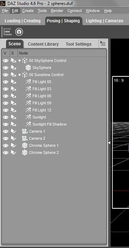

    Back in the Mystery Mobile (aka my lugtop), more help please from any DAZ Geniuses out there.
    I am using DS Pro x64 - 4.6.1.17
    1. Besides using sort ascending and descending in the menu for the scene pane how can I rearrange the scene items so they are in groups (e.g. lights, camera, figures) I am interested in parenting them. I just would like to have items grouped together so it is easier to find them when my scene contains many elements. I have already tried numbering them, which works but is cumbersome.
    2. When I am in the Pose/Shaping tab and I select "Texture Shaded" for the view port, my sky mapped sphere appears black, but when I choose Wired Shaded I can see the sky map texture.
    Why is that happening and is there anything I can do about it?
