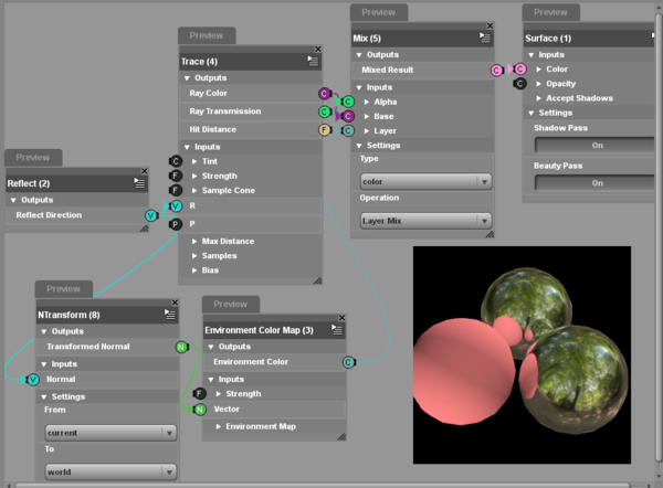

  • millighostmillighost Posts: 261
    With reflected objects "in front" of the environment map:
    913 x 672 - 164K
  • DimensionTheoryDimensionTheory Posts: 435
    edited November 2013
    That shader setup looks like it works well to provide the visual effect but I don't think that it would provide any speed increase in areas using the environment map, since it is raytracing the whole surface and using the result as a mix. Were you to restrict the raytracing by distance like Richard had or by ray depth like I mentioned, you could ray test to determine if that part of the surface is raytracing a reflection and map the environment only where it's not.
    Of course it traces the whole surface. I do not think there is a way to determine if a traced ray would hit a surface (or if it would not hit a surface) without actually raytracing it.
    You can limit the ray tracing distance on the trace node. I did not understand the part with the ray depth, though.
