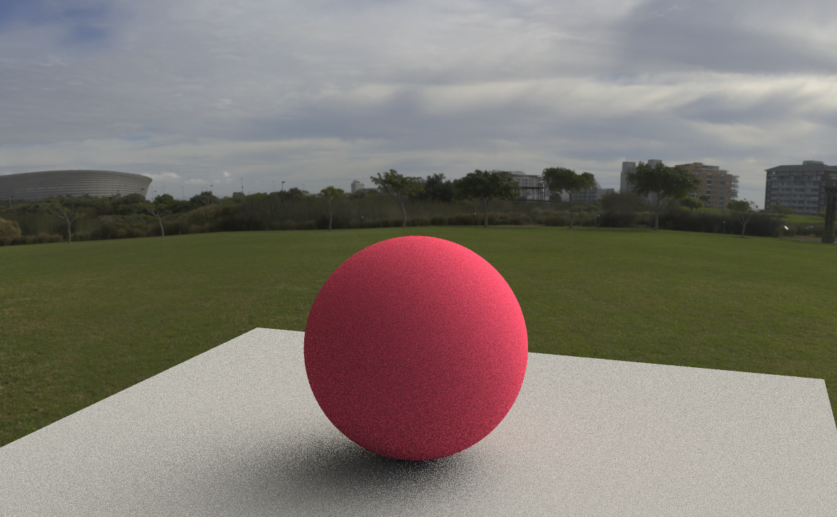

    Not sure what you mean, HDRIs do work with UE2. The UE2 environment sphere needs some edit though, you need to select all polygones with the geometry tool and flip the normals to get correct light direction, also visible in render needs to be turned on if you want to use the HDRI as a background.
    Very quick and dirty render with a HDRI from HDRI Haven and UE2 in bouncelight mode, default settings:
    However, this is pretty old tech, I suggest you look into IBL-Master for both IRay and 3DL, looks so much better, renders so much faster and is so much easier to use;)

    Use IBL-Master instead! The IRay and 3DL renders are synced so light direction is the same, load an HDRI in the Iray environment and it shows up in 3DL or vice versa:)
