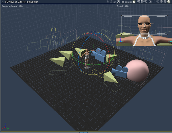

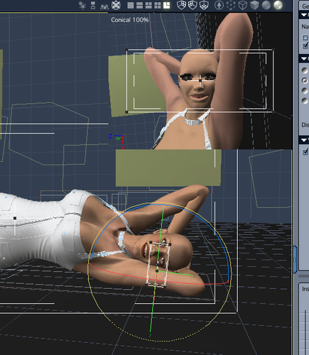

    You came here asking about Posing. In Carrara, the tutorial that I linked to in the beginning might not explain exactly how it works - but it does work beautifully.
    Posing characters - even without any tutorial - is very fluid in Carrara. You can do it by using the dials or typing in numbers, or you can just grab parts and move them around. Animating is a dream!
