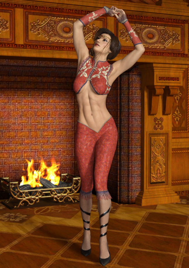

Hide the feet using the eye in the scene tab then turn off smoothing and hope there's not too much poke through elewhere, you can also turn off the shins. This usually works ok.
This is the Dark Storm Boots for G3F on a G8F base. After posing you nmay need to 0 out and toe or foot movements.

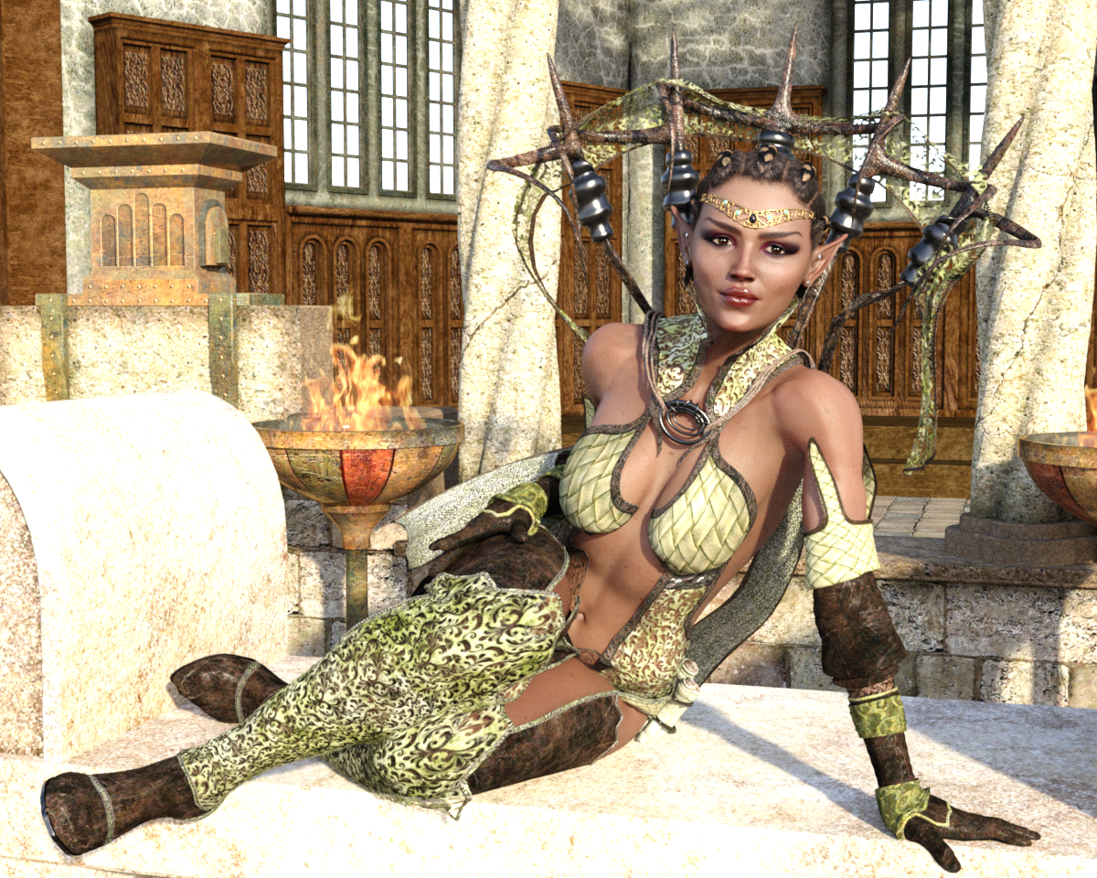

Sometimes it's the simplest of solutions that seem too good to be true, but alas, this worked with a Genesis 2 outfit I really liked. Behold....
This is Princess Fraeya, an Elven character I created using the Ellis 8 package which is an add on for Bridget. She is still a work in progress, but this is my first render of her. The outfit is the Briar Princess Outfit for Genesis 2:
This was one of the outfits that I bought that exhibited the Gen 2,3 on Gen 8 high heel issue, and I was pretty upset about it too as this was one of the outfits I really liked and wanted it to work. The boots are very fancy and are matching to the set. In a case like this not having the right shoes just breaks the look of the outfit. But thankfully do to this simple little trick, it worked!
I did what Scorpio said above, I just hid the feet. I didn't think positioning would have worked once you do that, but it does! The evidence is above. I have my new character sitting pretty, catching some rays on her outdoor daybed...Darn it! I forgot to put a pillow on that daybed!
So despite using converters or going nuts with remapping and what not...sometimes the simplest of solutions just stares you right in the face. Now I am wondering if this trick will work all the time...or in the very least for the Gen 2 and 3 outfits that I already bought.
https://www.daz3d.com/briar-princess-for-genesis-2-female-s
Thanks Scorpio and everyone else for chiming in to assist.
