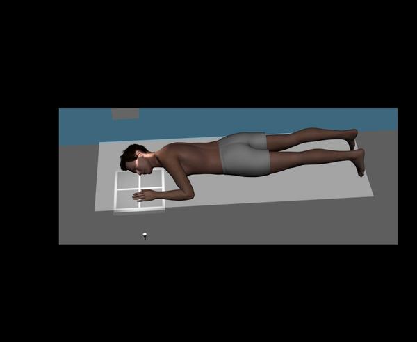

    i try all settings in symmetry dialog,i nothing,...i click on power pose,select arm and bend,a select left forarm and twist and bend,and select hand and alosoe twist and bend little twist chest,.... manual i do all,....but symmetry work when i select left leg,and i go to symmetry dialog and he alsoe do on the right,...but i dont know why dont work on arm and all of thing i do,...? i put a picture of my pose
    878 x 719 - 67K
  • todoricurostodoricuros Posts: 0
    i just want to do this just with right hand and alsoe put head on other side....
  • Richard HaseltineRichard Haseltine Posts: 111,251
    So you want to swap the left and right arms, and perhaps twist the body the opposite way, while leaving the legs alone? Select the abdomen, Set Nodes to Selected, Propagation to Recursive, Direction to Swap Left and Right, and Trunk nodes to Mirror Y/Z Rotations.
    it is preety good,but not good :)
    878 x 719 - 59K
